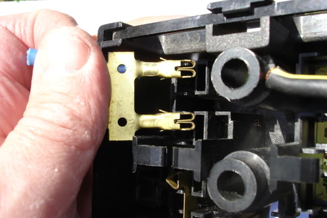

Many of the Wires that enter the Bussed Electrical Center, are not individual/ separate from other Wires.
Some Wires are attached to a Bus (multiple Terminals that are attached to each other) shown below:
The Bus may have 2 or 3 or 4 Terminals...
You have to remove the entire Bus, with all the corresponding Wires attached.
Each Terminal has Locking Tangs that must be depressed to release the Bus from the back of the
Shown below:

Awesome, thank you for the pictures, that helps a ton!
