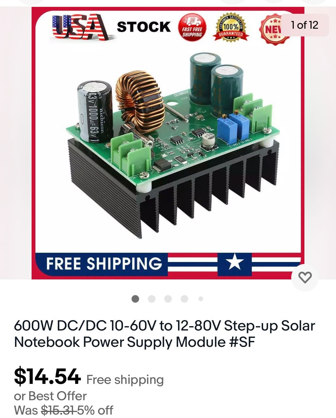

Can you give me some examples of half bridge converters

This seems like a more affordable option to the Window Racer
