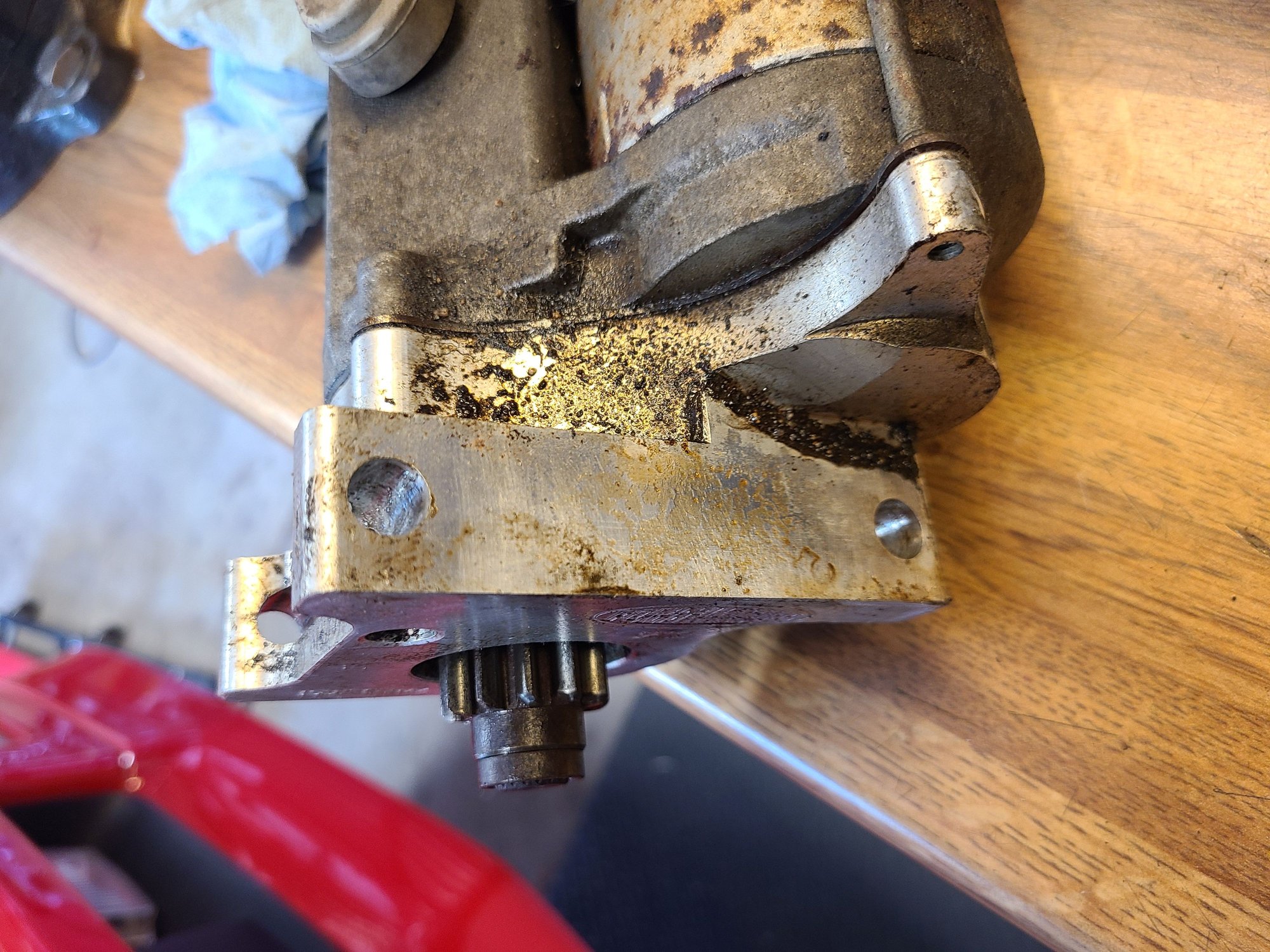

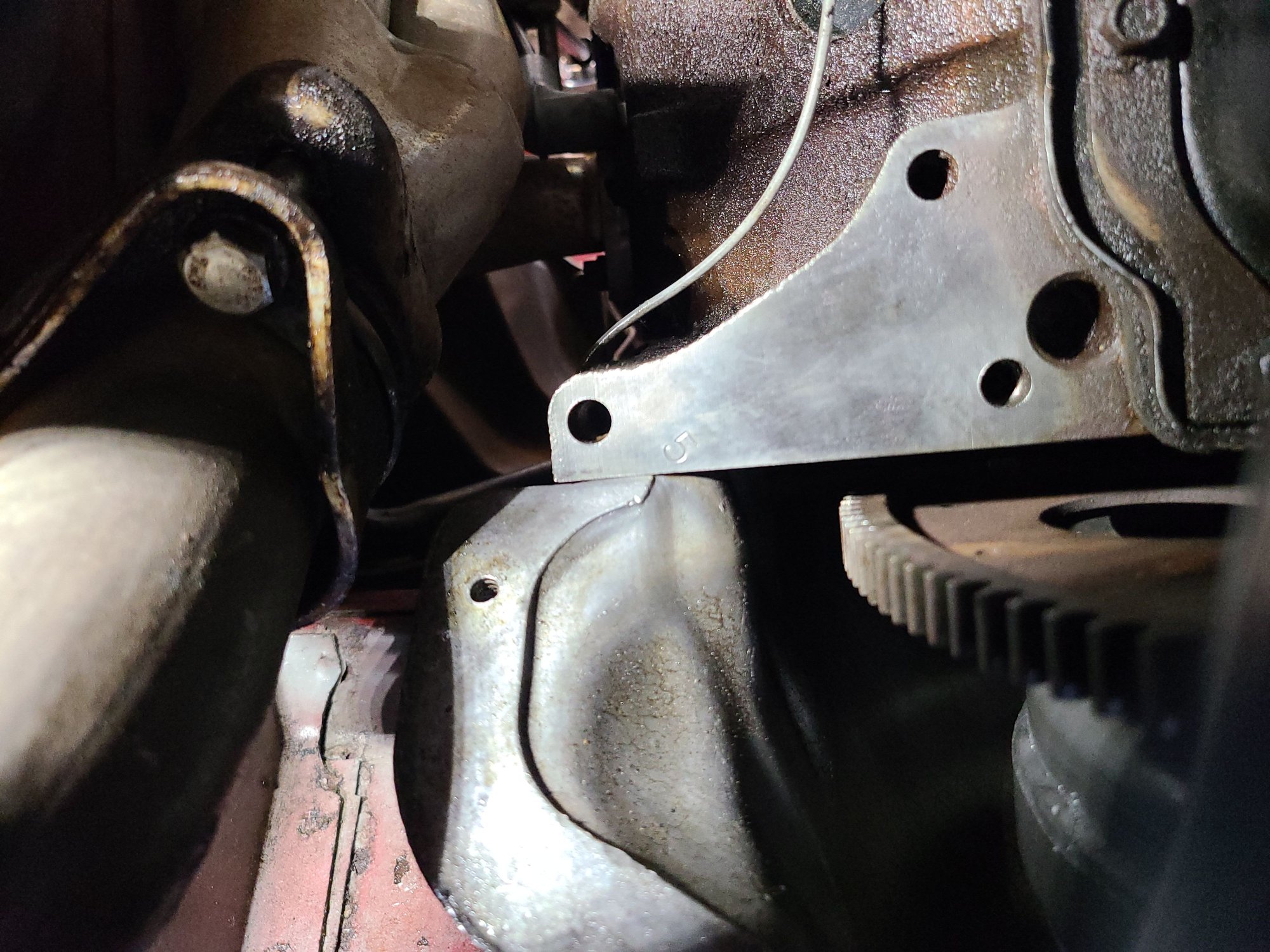

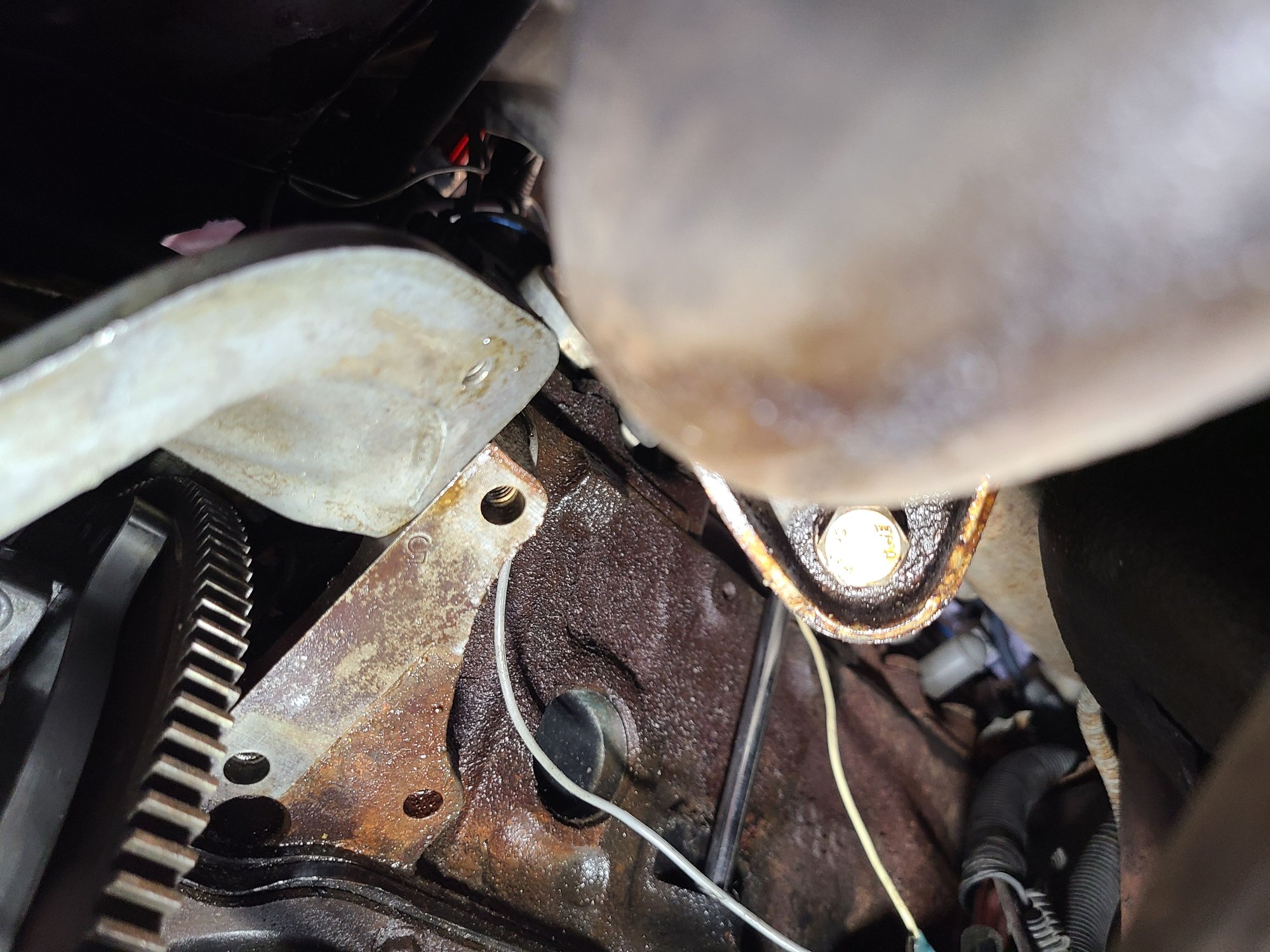

I think I've got it fixed!
Seems to be one of the two things I did resolved the issue. First I fully removed the bolt from my wuick disconnect I use for the ground of my battery, and theroly cleaned all the contacting surfaces, then re-applied dielectric grease. I found that with many disconnects and reconnects each winter, it seems it was asking leaving little raised marks on the contact surface, in the little Valles beside the raised areas some corrosion had formed. I put the bolt in a drill press and used a file to clean and flatten the underside of the head where it makes contact.
Next, I replaced my starter. The old one was about 20 years old. It was a high end power master mini unit, but it's seen winter driving and outdoor storage from years ago... I replaced it with the cheapest current power master mini starter that could handle 10:1 compression, since I'm building up a new wngine this winter. I found significant rust and oxidation on the block where the starter mounts. The instructions specifically say that area must be clean and barebecause the bolts are not enough to properly ground the starter to the block. When I reinstalled the new starter, I also put I bit of dielectric grease on the mounting surface before torquing and re torquing, to hopefully protect against future rust. I do admit this starter is noticeably weaker than the older higher end one that was having issues...
Pics to follow...

Starter as removed. Some oil residue layer on aluminum mount.
Clearly significant rust on engine block mounting surface.
Mounting surface after cleaning up with wire cup wheel on a drill.
