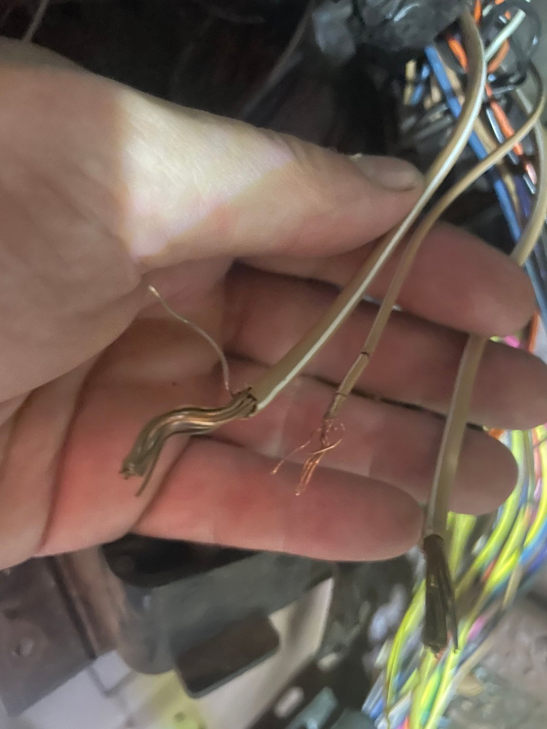

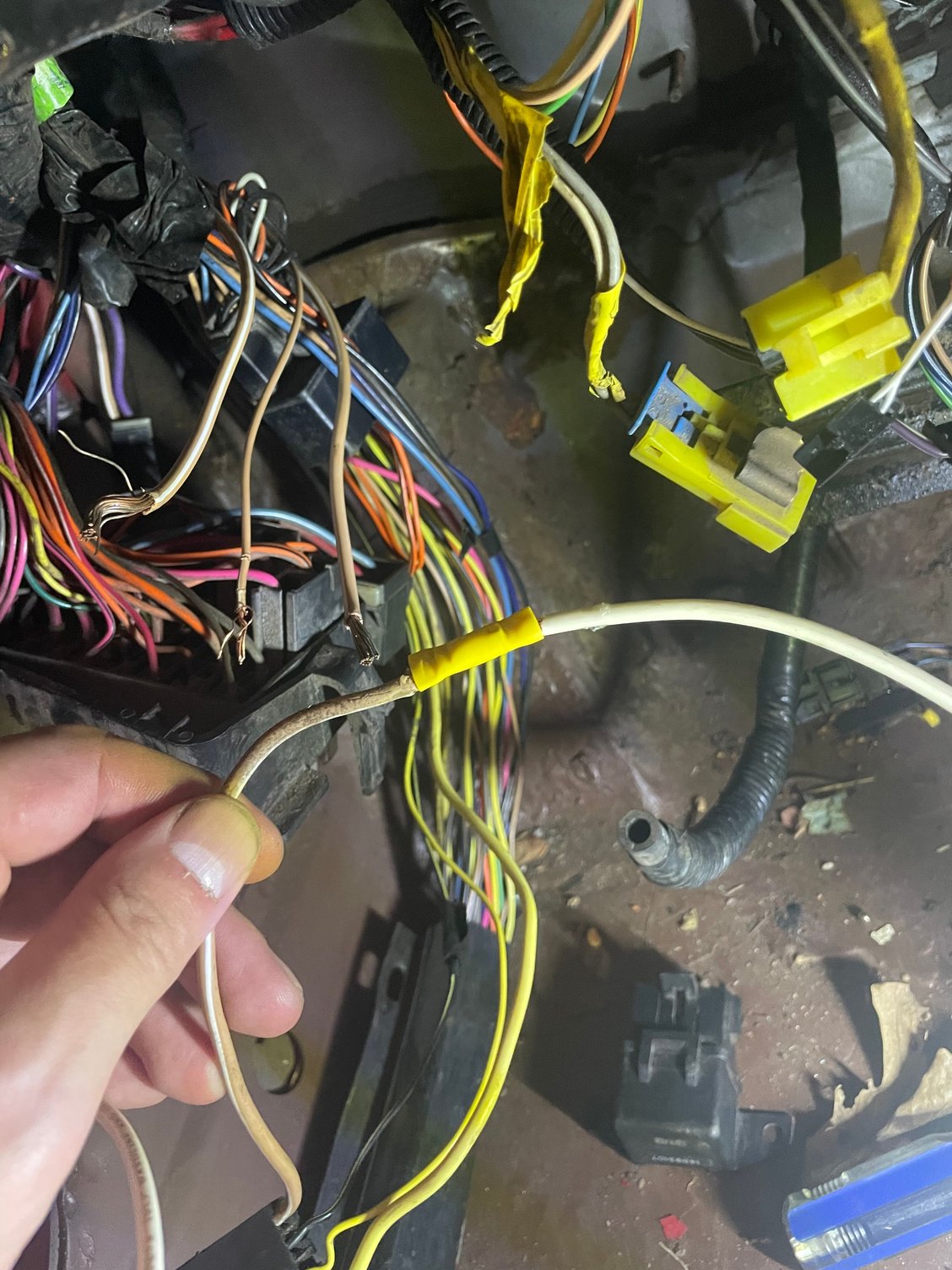

Update! So I found a year correct steering column to replace the dismantled column that came with the car. I installed it and went to start it and wouldnt you know, same symptom ( car starts in accessory II mode but cuts out power if you go to ignition on. This rules out if ignition switch and ignition. Time to trace wiring and figure out what it going on. Wouldnt you know it, the main power to the starter off the relay has 3 wires spliced into it, not factory of course. Pics to come. I cut the 3 wires out and ran a single wire from the relay to the starter wire(2nd pic ) and wouldnt you know the car cranks and starts as it should. Unfortunately, now there is a new issue. The injectors are not firing correctly now and car wont idle, just starts and dies. Injectors arent firing. I believe one of the three wires that was connected to the starts relay wire is an injector wire because the car would run and idle when all three wires were connected to the main starter relay wire. Now I have to figure out what the other wires are and where they belong. I hate wiring. Anyone got thoughts or ideas?
