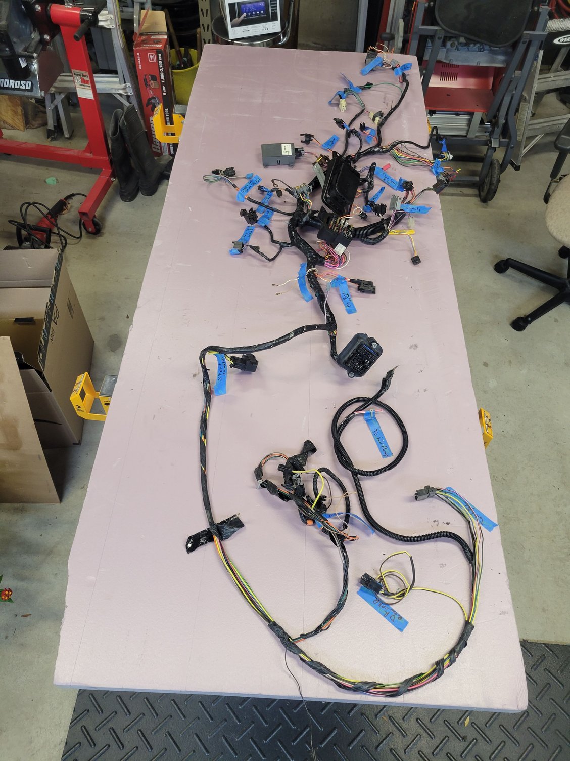

Thank you for all your help. Now I find that with "more information comes more questions". Before pulling out the 305 I labeled most things (wires) fairly well. I got that computer harness unplugged and out of the bird as a whole. What a huge difference it made. After bringing the computer harness into my garage I noticed 2 wires/plugs that I have labeled water pump and water neck. I feel like one of them is the sensor that kicks on the electric fan. In fact I purchased some parts this weekend from a guy with a similiar car and I saw that he didn't have sensors or wires going to the water pump or water neck. Unfortunately he didn't know much else but said that all of his gauges worked. So the questions: 1. What does each do? 2. Do I need them? 3. If not whats the fix?
