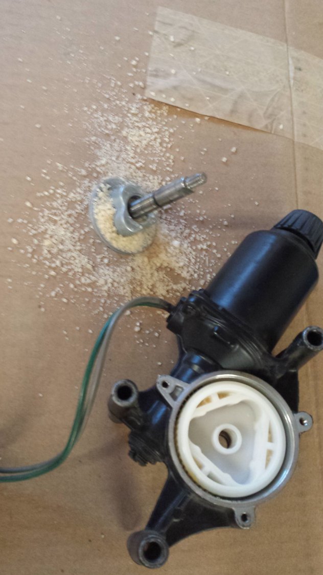

Most of the time the gears are fine, it's the little drive pucks that turn to dust. This shows a upgraded brass gear.
i have seen 1 car where the shaft was actually spinning inside the pressed on cast aluminum piece that helps drive the pucks. (Lower picture with crumbled plastic)
