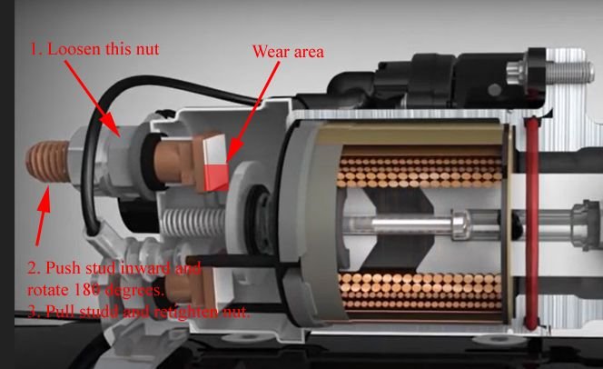

Sometimes, the symptoms described can be worn solenoid contacts within.
Back in the day when I was cash poor, I would do this to get more mileage out of a GM solenoid with worn contacts (pardon the spelling):
It's more cost effective these days to just replace the solenoid.
