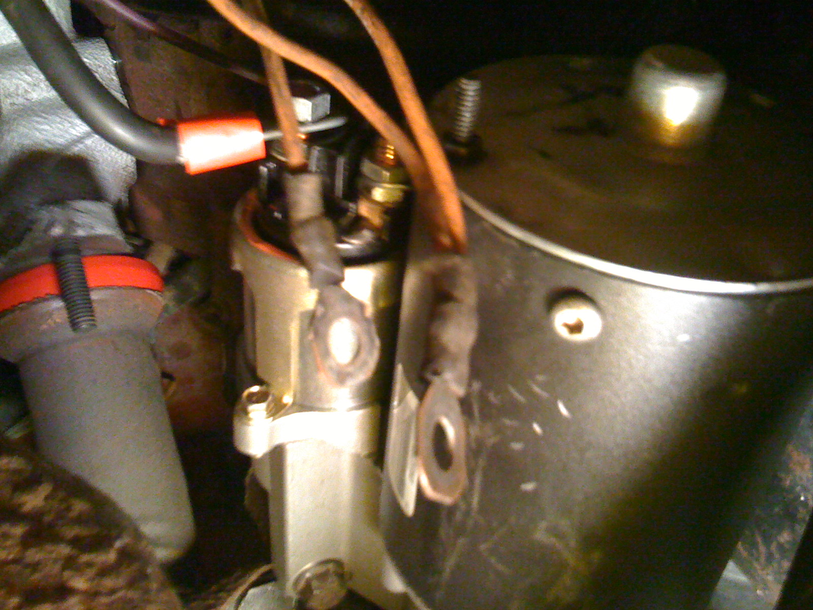

Old Feb 18, 2011 | 04:15 PM
theNMBR27's Avatar
Joined: Sep 2009
Posts: 516
From: Downers Grove, IL
Car: 91 Z28 / 04 GTO
Engine: GMPP 350 TPI / LS1
Transmission: WC T5 / T56
Axle/Gears: 3.23 / 3.46
Re: Wiring problem
In the picture the 2 large wires go to the big bolt and the purple wire goes above on the small one.
Old Feb 18, 2011 | 04:35 PM
chevyssman92's Avatar
Joined: Feb 2011
Posts: 10
From: Batavia, Oh
Car: 92 rs camaro
Re: Wiring problem
Thats what i got a starter for..i mite just get the same as what u got then
