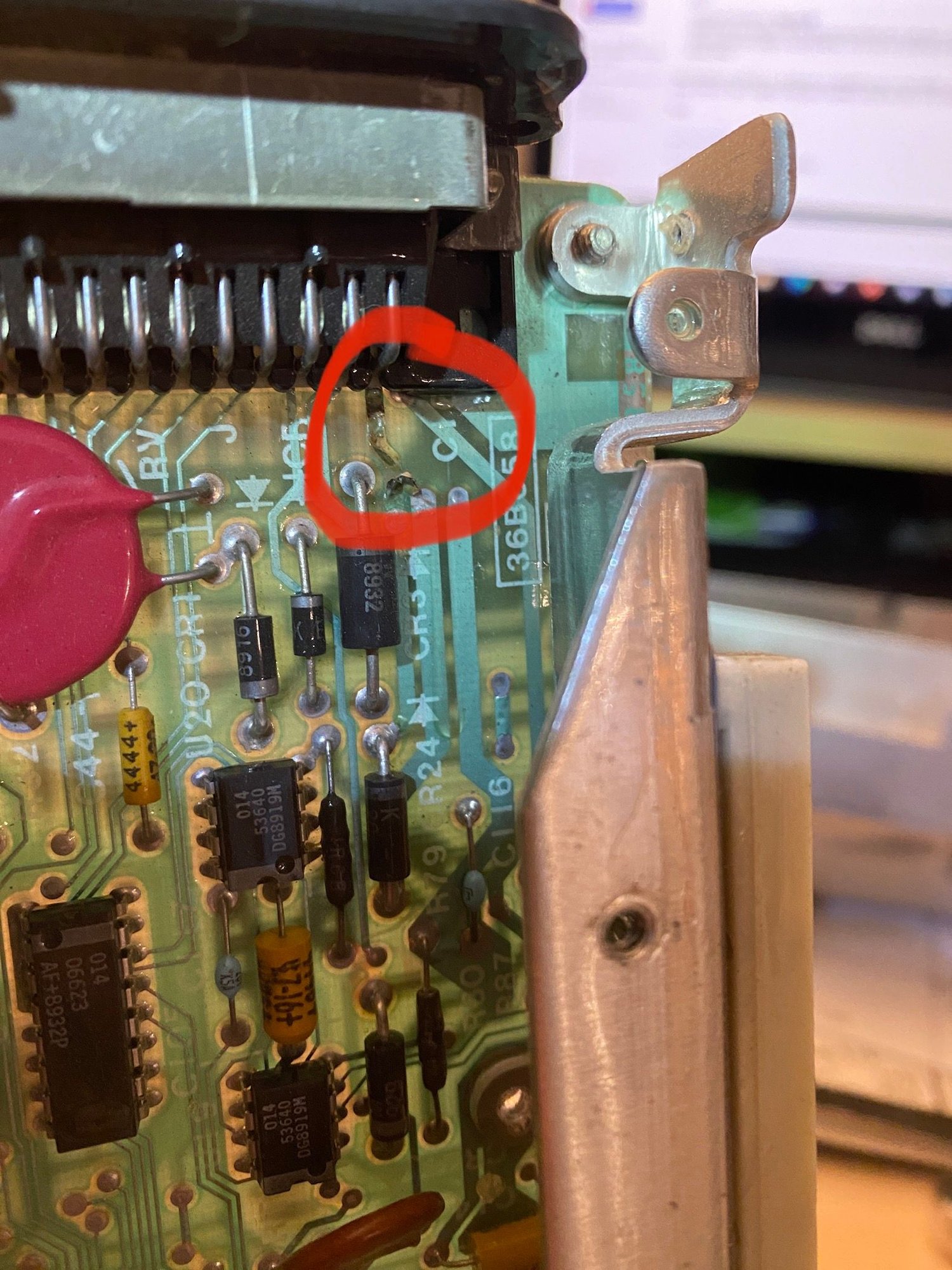

Fast flickering SES/CEL is a checksum or MaskID error on the PROM. So either the PROM is bad or it isn't the right ECM. Can check chip U7, last 3 digits of the part number is 434, for the '7747 ECM.
RBob.

Verified last 3 of the U7 chip were 434, but I ordered another used non-reman 1227747 ecm from ebay anyhow. I dont trust this rock auto cardone reman. Looks like someone sprayed some kind of coating all over the motherboard. Must be part of the “reman” process. Well it looks terrible. Ill save it if it turns out to be a good ecu. I did find at least one thing that killed my other ecm. A melted section of solder circled in red below. Such a waste of a perfectly good ecm.
