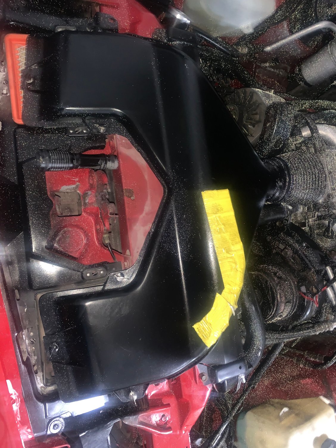

Re: ECU
Here are some pictures of the air dam air inlets. Filters look ok but what do you all see? Crack on the body of the ports that’s been taped up.

Thermostat temp in these cars is usually about 195°. At some point they switched to metric designations and they're not exactly the same, but close within acoupla °. Like, 90°C or something. That's what it should run at, driving down the road at cruise speeds like 45 - 70 or the like. Might take some time to reach equilibrium but that's where it should eventually end up.
A fan switch in the head would have turned the fan on at about 235° and off at about 210°. Not sure what the ECM controlled version is set for but I'd expect it to be pretty similar. Since the boiling point of 50/50 water/AF coolant at 16 psi is about 265 - 270°, that's plenty cool enough to stay out of trouble. Make sure your system has no leaks and the rad cap is good, so that it will hold pressure properly; and run between 30% & 50% regular green antifreeze in it. If it has any leaks it will spew because the boiling point will be so much lower because of the lower pressure; and the AF does lots of good things besides lowering the freezing point, including raising the boiling point. Maybe add a bottle of Water Wetter https://www.autozone.com/antifreeze-...2oz/486218_0_0 to help heat transfer.
If the fan isn't running then it's time to figure out why. Sounds like that's all that's wrong with it.
Pretty sure you can fix that crack with flexible bumper repair. Do it from the inside so it doesn't make a giant blob where you can see it.
