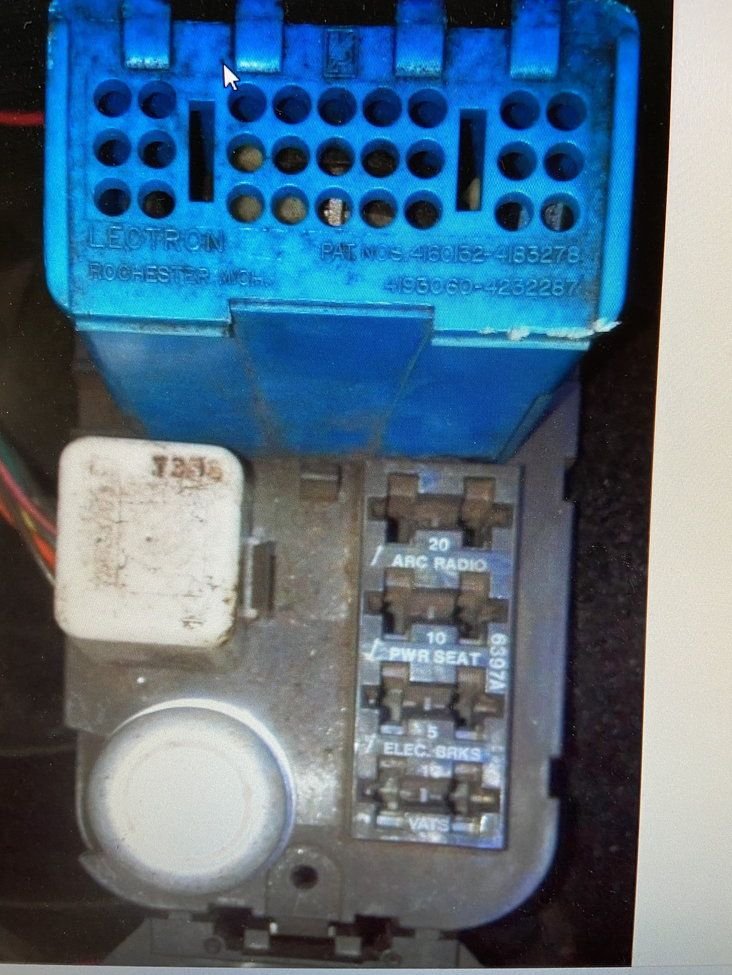

There is also the so called "convenience center" , if that was even a thing in 1984 ? I know later cars (like my 1989) have it, but I'm not sure if the earlier cars did.....

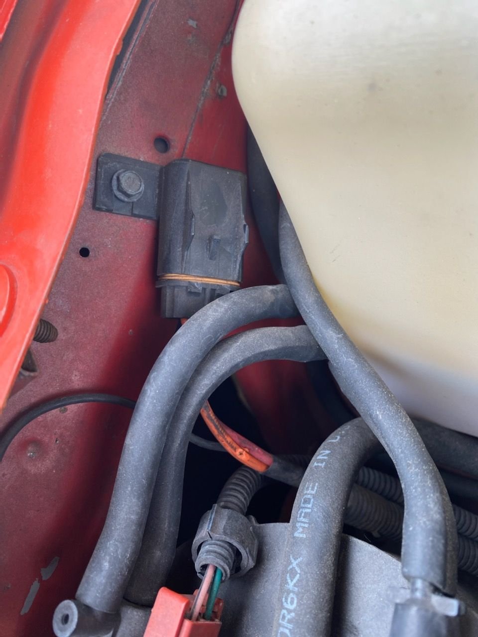

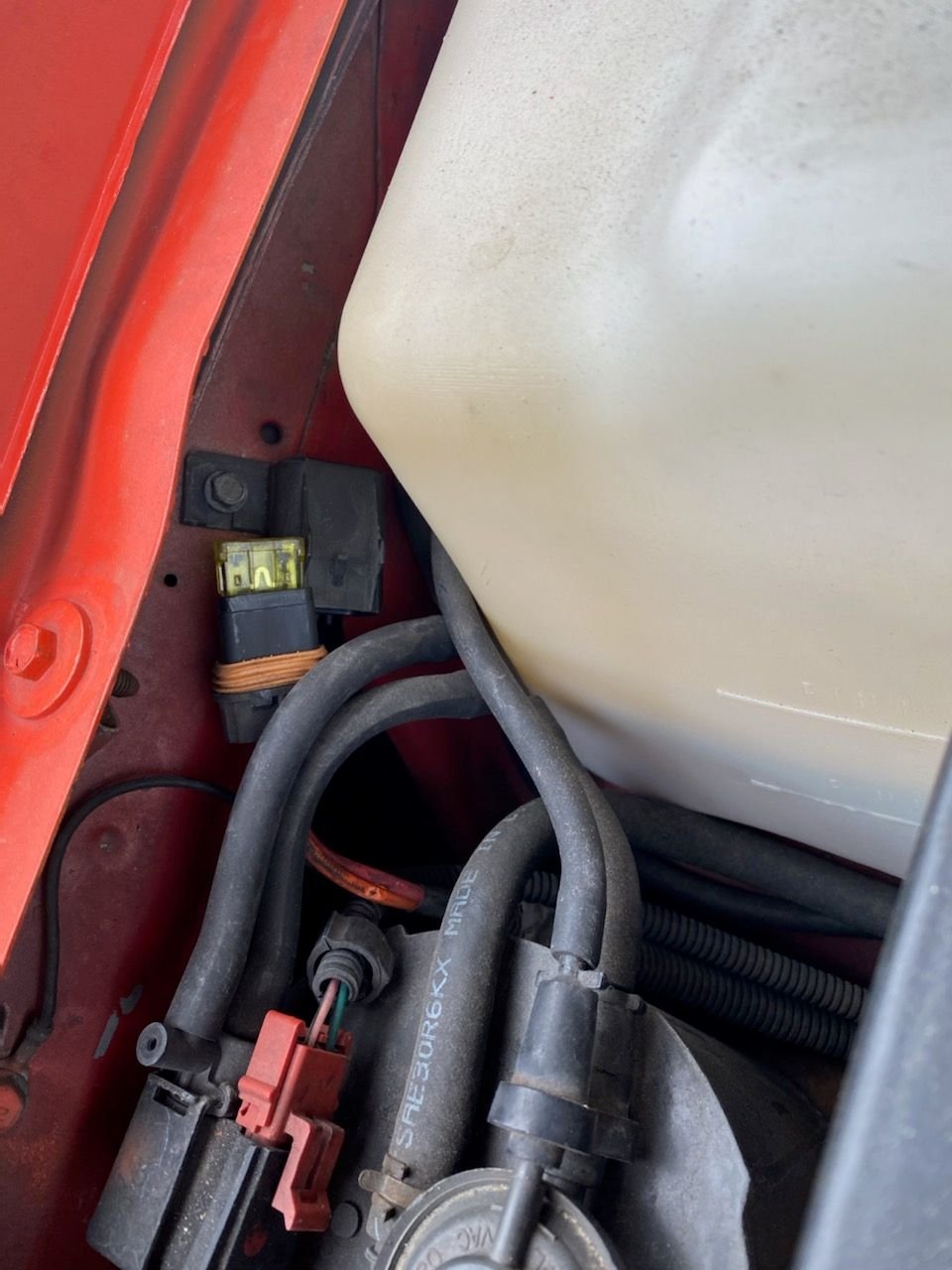

Also, all of the cars with an ECM have a stand alone fuse here ;
hey - i learned something today! never knew about that fuse.

The carbed cars didn't have the external ECM fuse. They just have one in the fusebox.
Yes the early cars had the "convenience" center. It has the key buzzer, choke heater relay, OBD1 connector, and a couple of other minor goodies in it.

Is the "Convenance Center" fuse box supposed to pivot down, for access?
Old May 17, 2023 | 08:07 AM
Posts: 27,933
Likes: 2,454
Re: 1984 TRans AM - fuse boxes
Not that I'm aware of.
It's not "convenient" to the owner at all... I think that word only applied to the mfr. If memory serves, a few largely inaccessible screws hold it in; if you have the dash out and laying there, it's super easy, but with the whole car put together and you laying up under the dash, it's ANYTHING BUT "convenient".
