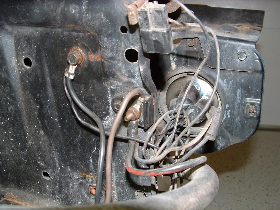

Hi bigjim08,
You haven't said what year your car is, but then again I'm not sure if the headlight ground location changed during the 1982/1992 run of these cars. I have here a generic headlight ground pic that I shamelessly swiped from some website or other, you'd be looking for a couple of black wires (one fatter, one skinnier) bolted to the metal next to the radiator like shown here. There are two, one on the driver's side and one on the passenger's side. This isn't an exact third gen pic, it's the only handy headlight ground pic I found, but should give a good idea of what to look for

Hi bigjim08,
Thank you very much, I have a 1988 Iroc z...
I have 2 black wires on the passenger side and 1 on the driver side...
