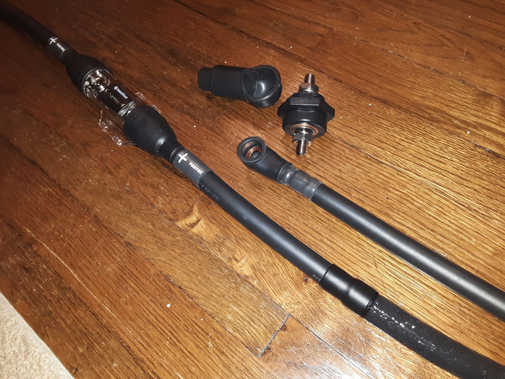

Re: Best Wiring Heat Protection?
The Bottom Right-Side of the Image...
(TechFlex Aero-Fireflex Sleeving):
Well if we are going to get Serious in terms of Materials...
This might be the most beautiful damn thing I've ever seen... Thanks guys, this all is exactly what I'm looking for!!
