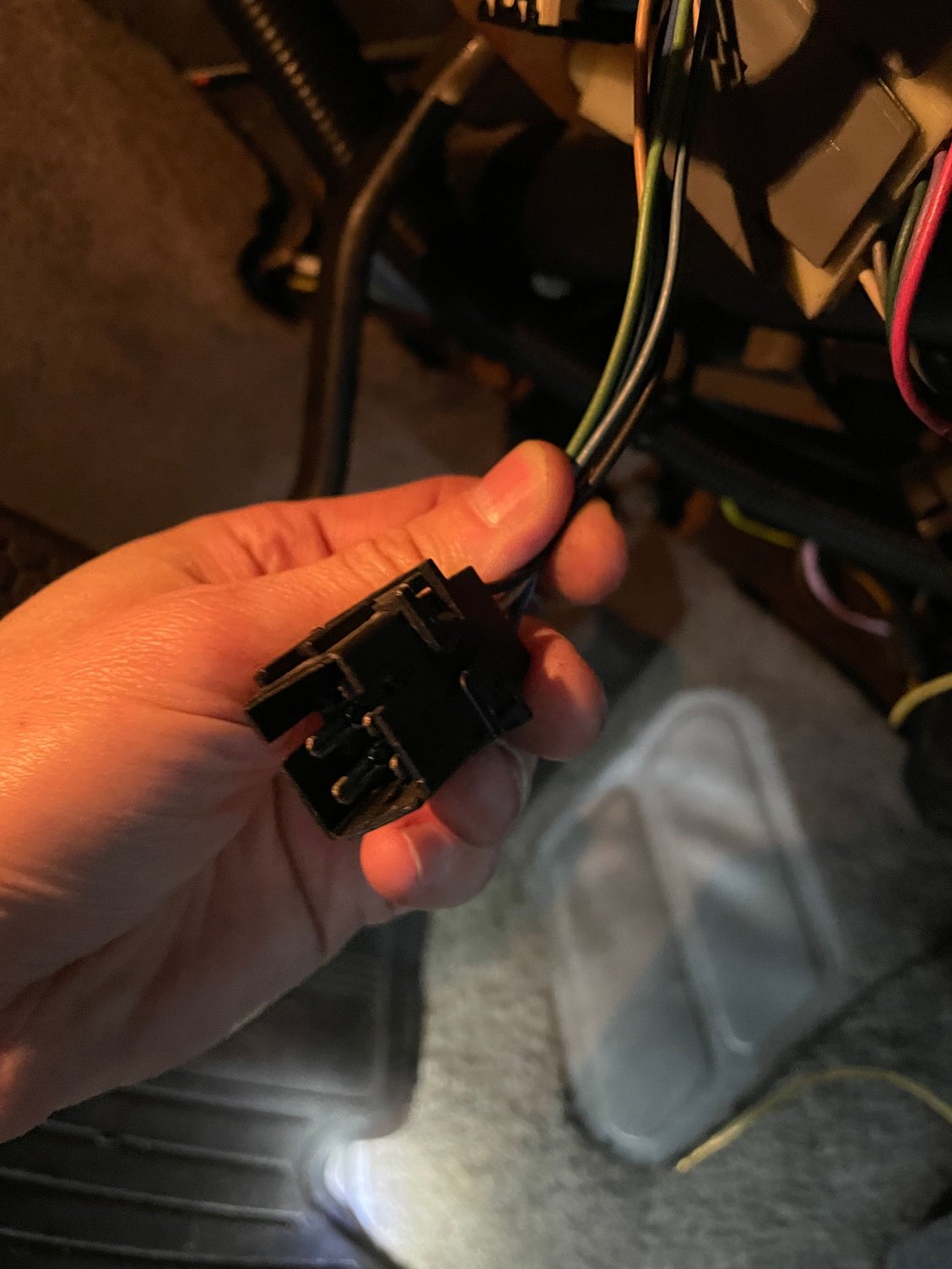

What’s this plug hanging directly under the steering column? I just noticed it and not sure if there’s supposed to be something plugged into it. 87 LG4 car. Thanks in advance.

I’m looking at a crappy screen and can’t see wire colors, but to me it looks like the Cruise Control connector. IIRC it connects the cockpit cruise module harness to the engine-bay cruise wiring harness.

That sounds right. Cruise left the chat on my car decades ago. Thanks!

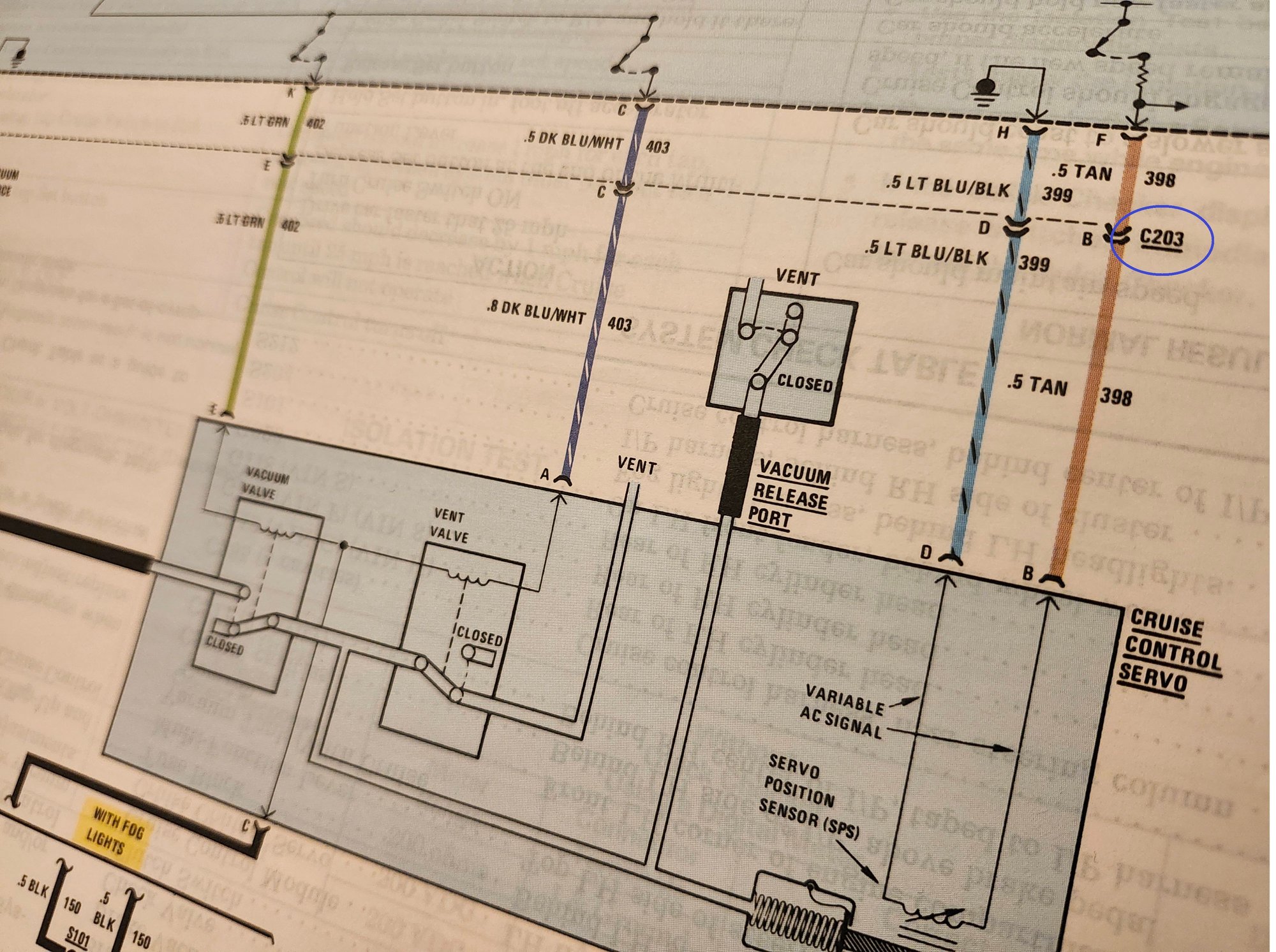

I agree, it looks like the C203 Connector for the Cruise Control Wiring.
Circled in BLUE (Letters: A, B, C, D, E) on the Two Diagrams below:
