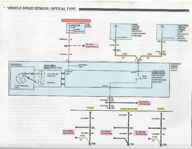

Trying to figure out wiring for 88 Iroc with TPI. Haven't pulled cluster yet but since it has stock transmission and cable have question about VSS signal and VSS.
From research the speed signal goes through the yellow
buffer on the back of the cluster and outputs 2000 pulse per mile. That signal then goes to the cruise and ECM.
My question is what does the ECM do with the VSS signal?

Tcc lockup, iac control, fueling based off load /speed, speed cut off. Why ?

Was hoping if I could ignore it Doing a Dakota install so looks like I need to tap back to the ECU the speed signal since it actually matters.
I am looking through the wiring book as to which pin it is on the ECM as looks like a brown wire.

If you have an automatic transmission, the ECM uses road speed as one of the deciding factors of deciding when to lock / unlock the torque converter clutch.

Oh that was what I was trying to figure out if it mattered and appears it does. I will wire it up so the speed output from the Dakota box gets fed back to the ECM connection.

Your '88 will have a speedometer cable between the trans and cluster. The optical pickup on the back of the cluster creates the VSS pulse stream.
The Camaro's went to the 4-PPM magnetic trans mounted VSS in '90.
