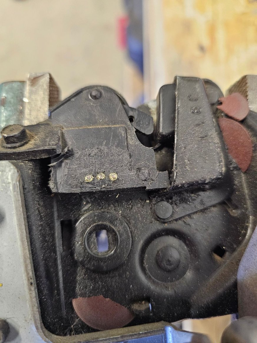

First, I ground down the stupid plastic that was in the way. It had been melted and abused, and the electrical contacts had sunk way down. So I got a grinding bit in my drill and just got rid off all the extra gunk.

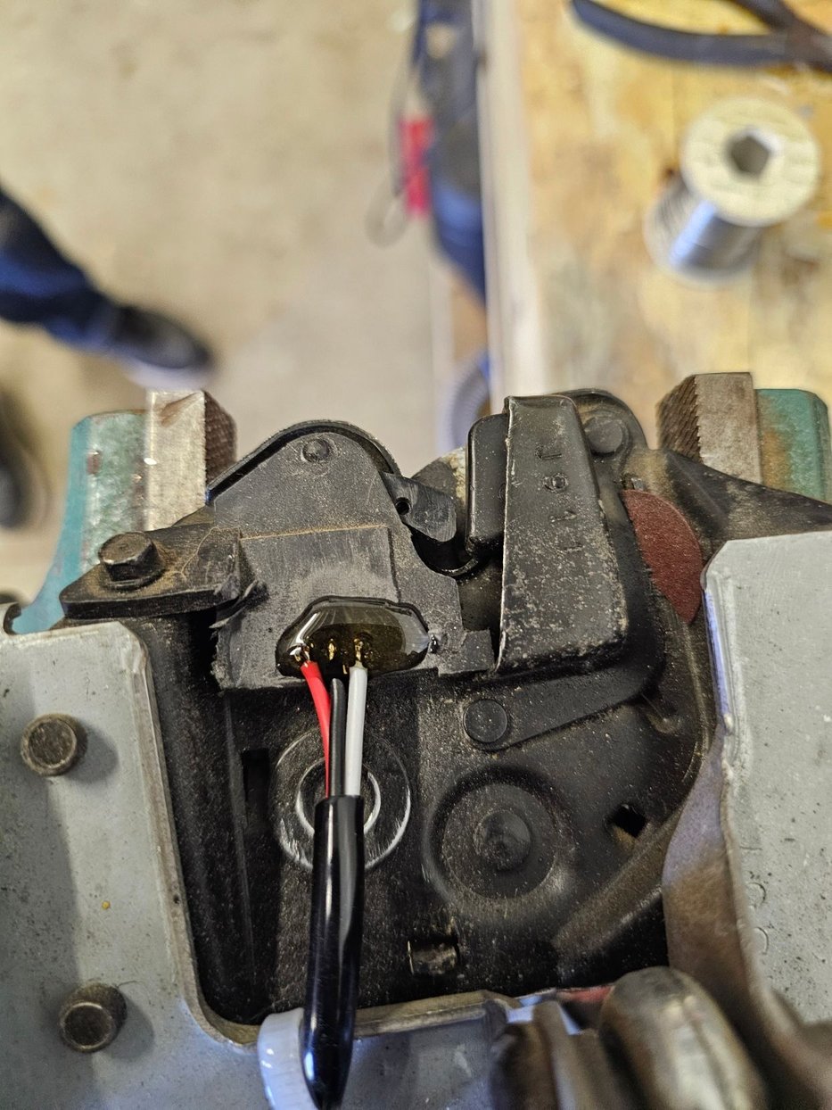

Then, I used this nice little sleeve of three wires that my dad had. We worked together to soulder down the fires and then attached them PERMANENTLY with gorilla glue. you can see we used zip ties as a sort of extra back-up strain release just in case anything got snagged.

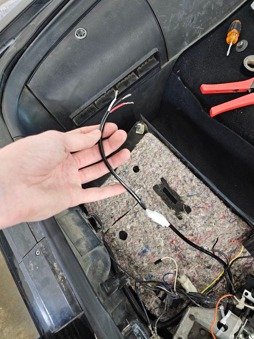

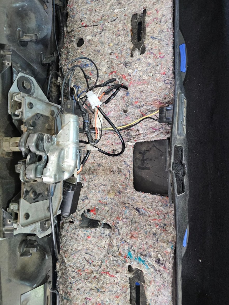

Finally, we connected the other end of the wires (shown here) to their respective wires from the wiring harness. I left extra slack so that things wouldn't end up having stress on them.
Then I reassembled it all. My back panel looks just a little strange because of my sub setup, but as you can see it all goes back together as it should.
