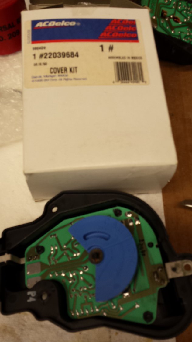

Can you take a photo of your cover? I have a few spares I was going to fix and sell.
I replaced the capacitors on my 86 board to get it to work again.

These are the photos of the outside and inside of what I need to get.

Yes, Yes, Alfisti , my 84 Camaro uses the same board and cover shown in photos on this page / with the blue half moon plastic piece over the board. I would dearly like to purchase one. The only thing on the car not working. Thanks for the e-mail.
spenc
Not the best shot of wiper but..it again it has the blue half moon plastic piece turning over the board.

On the early boards it's not just the capacitors that fail - the early model boards used a thin plastic arm (where the blue pizza slice is on the board pictured) with just a slender finger that breaks off.

Yes I know this. As I said previously, my car uses the wiper with the blue pizza shaped piece that rotates on the green board. Still holding out hope that I can buy one of your extra boards. Mine is the same as those pictured above. thanks for your reply.
