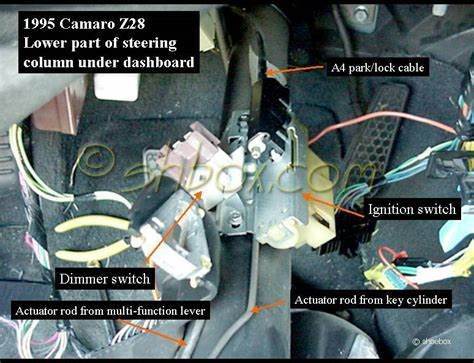

Also check the Hi-Beam switch itself. It can get hung up and not move all the way into hi or low position. the switch is at the lower end of the steering column on the top. You have to remove the lower panel under the column and get way back up there. The switch is linked to the stalk switch via a metal rod. The rod moves the top part of the switch back and forth to go between hi-low. I tried to find a pic from our gen but could not.
Our switch is located in a similar if not the same spot.
I was having a similar issue with the high low beams not working properly. I also have the same light set up as you but I use a harness for the H4 halogens. Anyway, the mechanical rod operation wasn't working properly is what mine ended up being.
