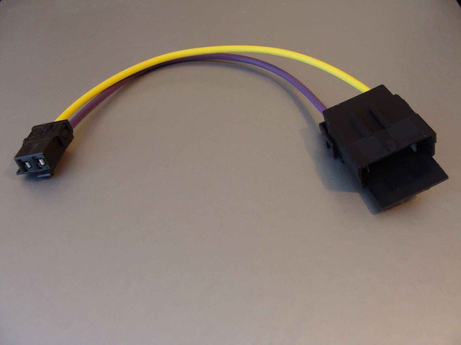

i have a 1988 firebird gta manual transmission i have determined the VATS module is bad and i am going to bypass the system. i have put a jumper wire on the starter enable relay but still have no crank but i have a plug under the dash with a heavy gauge yellow and purple wire with nothing plugged into it there is no voltage coming to the plug it self while trying to crank .can any one tell me what goes in this plug

Clutch pedal switch working ?

Not sure. I have a new switch for the clutch pedal but this plug is something else

Can anyone tell me where the large plug coming from my clutch switch plugs into?

found the problem clutch switch was un plugged lol
