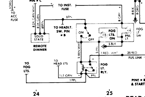

Is there a way to override the wiring in an 1985 IROC so that you can use the driving lights alone without using the headlights?

Maybe I'm saying it wrong, I want to use my driving lights only with my parking lights. Factory set up makes me use my headlights to use my driving lights. I went and double checked it today. I feel like there must a wire somewhere I can disconnect or cut that allows driving/parking lights on without headlights on.

On my 85 IROC i have to have the headlights on before i can use the driving lights. With just the parking lights on the driving lights will not work

They must have changed it for different years. Mine was an '86 and could run the parks and "fogs"/driving lights.

Take out the cross connection with the headlights, then you can turn them on independently.

It looks like you'd want to run a wire from your parking light output on the headlight switch, to the coil pin on the fog lamp relay, then by-pass the relay with the brown/white wire to the green wire to the headlights.
