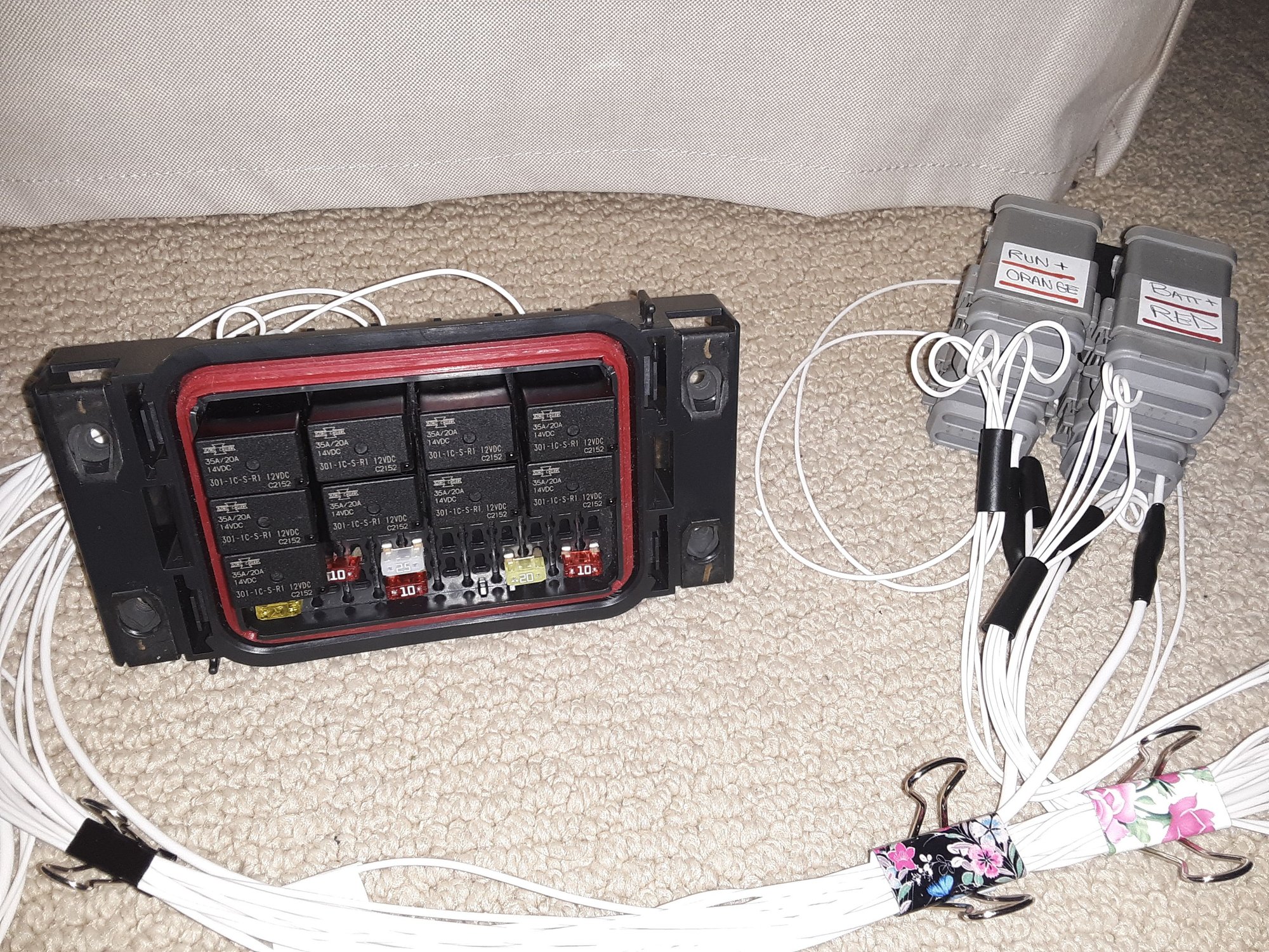

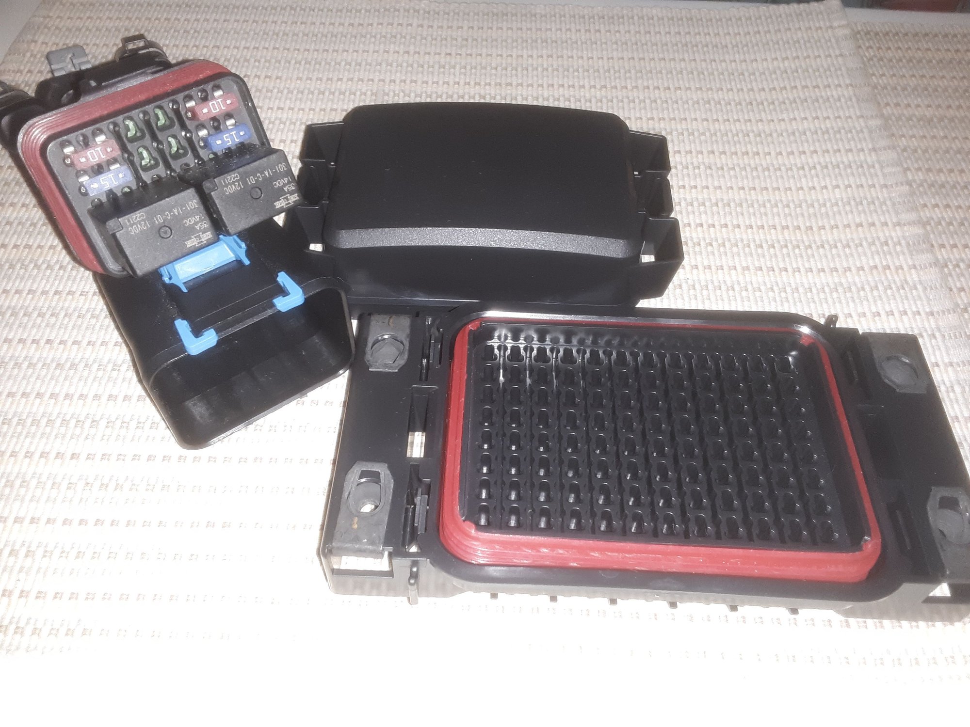

Here is some of My Sealed Interior Fuse Panels (IPBEC) that is being assembled.
Shown below:
The Square looking thing with Grey Connectors (Right Side of Image) is a group of Sealed Splice-Packs.
