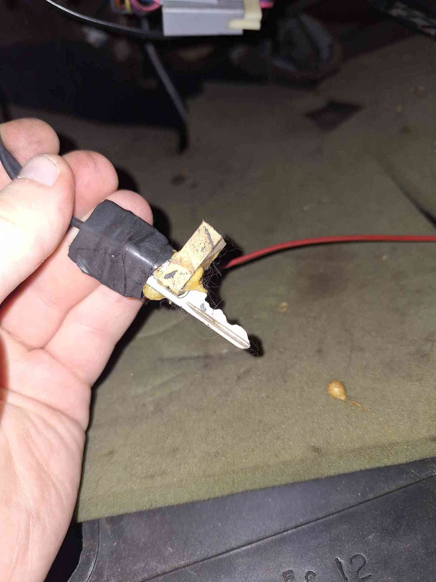

If I had to guess the key wired into the electrical under the dashboard is a weird way to circumvent the security system? It definitely makes me lean towards it being a hack job.

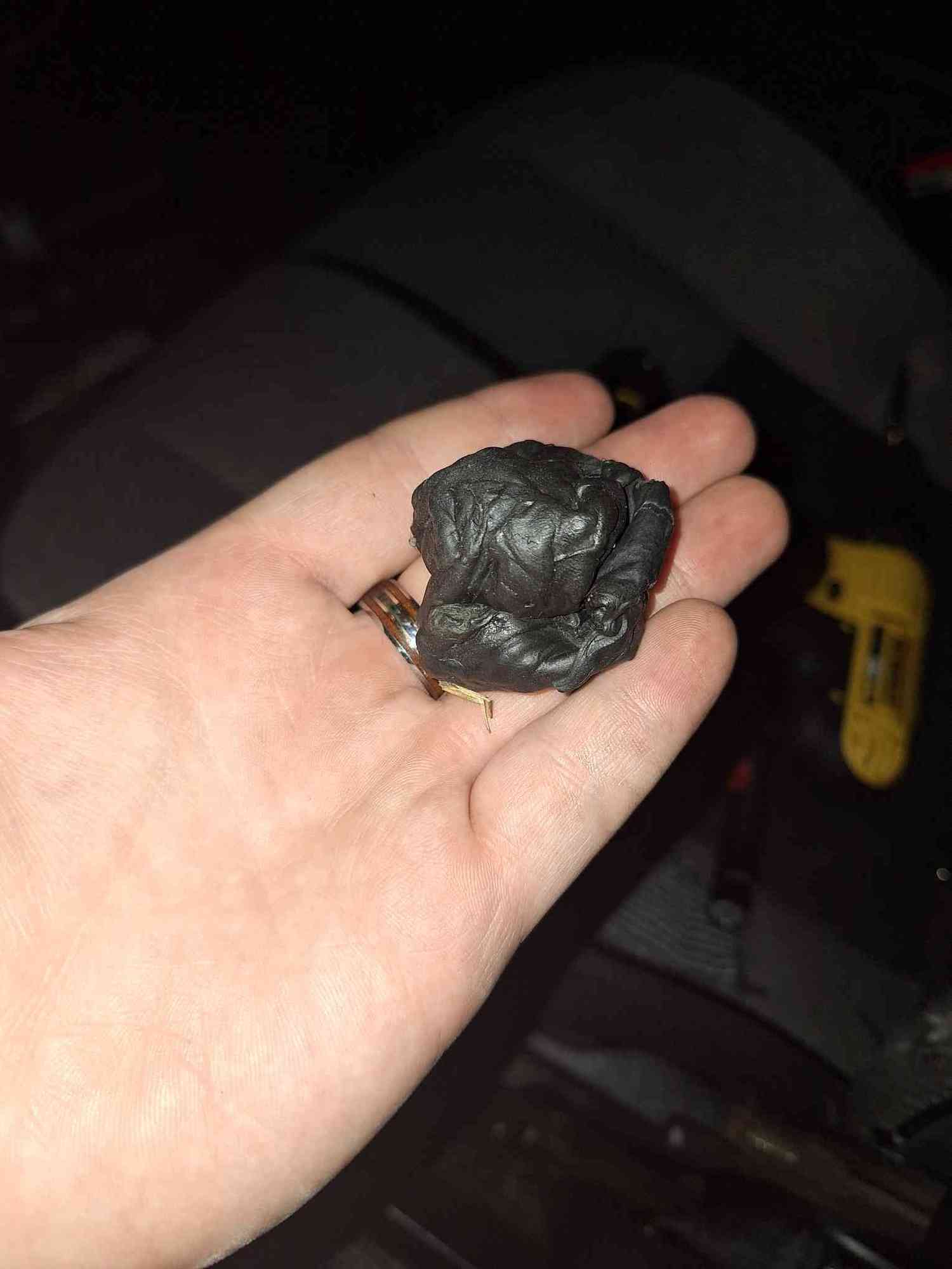

I've probably pulled 3 to 5 lbs of this crap out of the car over the past year. I've found it under the driver's side dash around the starter relay(?), near the ECM, stuffed into the MAP sensor, and in a few other places I can't recall right now. I'm really not sure what to do about it.

The rubber gooey gunk is part of the soundproofing / insulation that they used back then. It kinda dissolves and drips out eventually.

Yes the reason someone put the key in there that way, was to defeat the VATS system. That may have something to do with why it won't start. Yes it's more a less a hack job. Nobody out here can tell you how some PO hacked up the car, and paying somebody else to fix that, is kinda dumb; putting somebody else's kid through college or braces or some expensive sport, basically. First thing to do would be to trace the wires through the system; a fat yellow wire leaves the ign sw, goes to the neutral or clutch safety sw (same basic function for auto or stick transmission), then to the starter relay, which would need to be told by the circuit involving that key, that it's OK to let the car start. Best to start there.

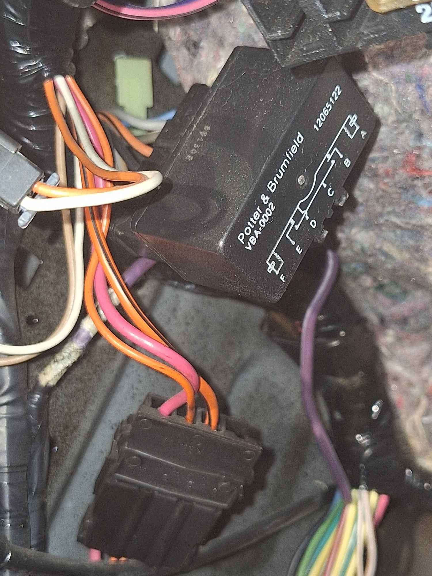

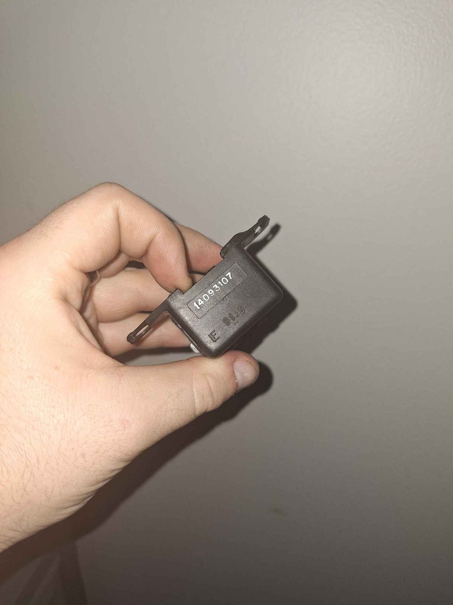

Everything I've seen said it should be behind the left hand kick panel near the hood pull handle too, but I can't find it there. I've found two other relays, which have part numbers corresponding to the VATS and door lock relays respectively, but unless I'm very blind and don't understand what I'm looking for (possible), it's not there.
^This is the door lock relay according to what I can find based off of the 12065122 part number. Definitely not what I'm looking for.
This is the VATS relay, from what I can find. I should probably replace it since it's fairly cheap and mine is a bit banged up, but it's also verifiably not my starter relay.

The NSS I would say is your neutral safety switch which is on the side of the auto shifter, That flat connector by the floor is where the starter enable relay plugs into. You can bypass it by jumping the two thick wires and it will fire up. You can also take a multimeter and get the resistance off the chip in the key and bypass the vats
