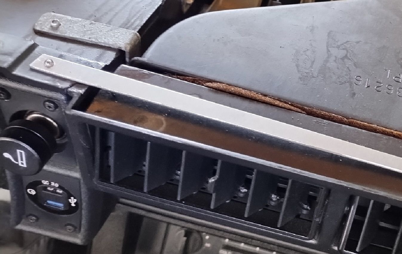

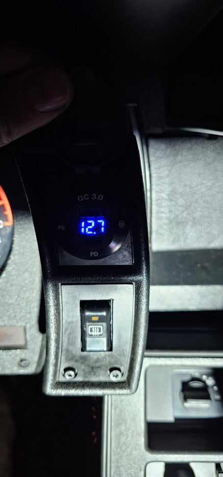

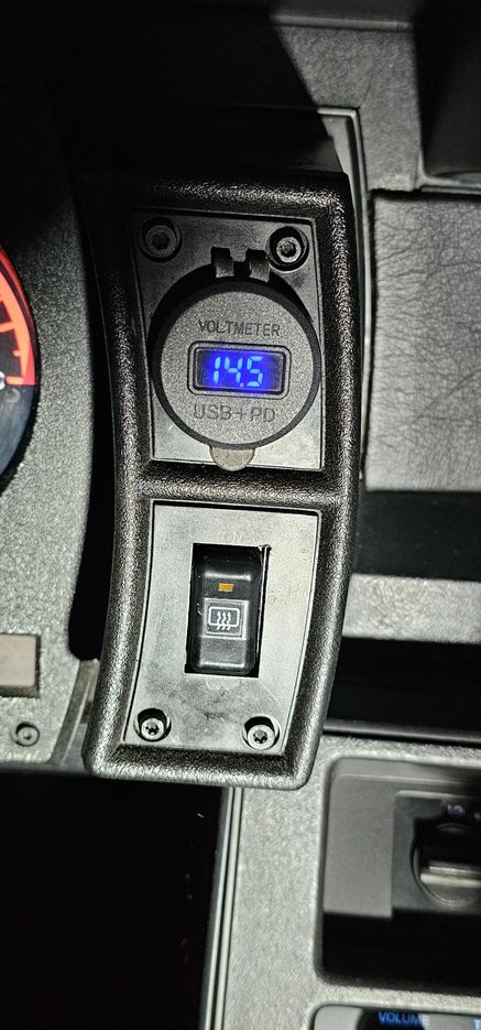

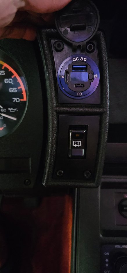

Since I don't smoke, and the lighter is pretty much useless, I went ahead and purchased an aluminum hard wired USB charger/digital voltmeter. The voltmeter is what sold me on it. Besides some minor wiring and making the lighter plate cover larger at the base with a Dremel little by little until the unit fits. Took me about 45 minutes to complete. Pics are large. But for those with vison issues like me, you're welcome.
