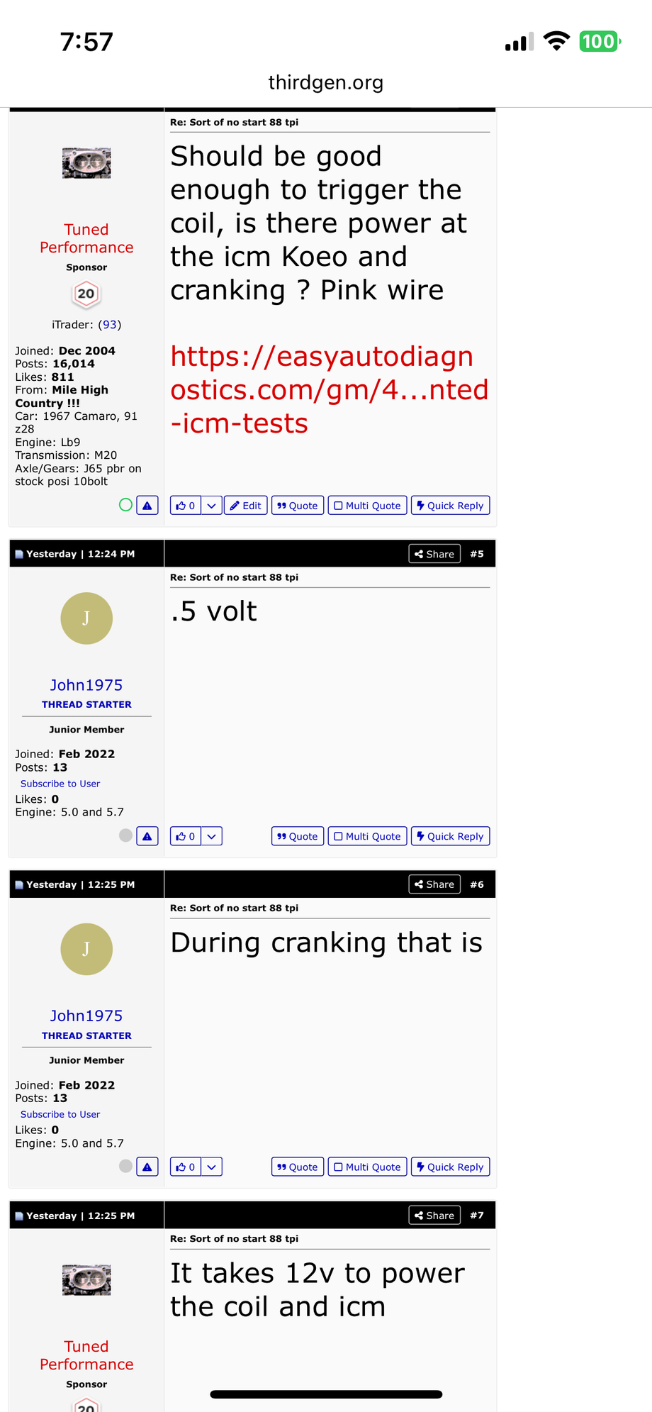

You will have the same issue with a carb if you only have .5 vdc at the icm. Check power at tc100 and ign sw.
You will have the same issue with a carb if you only have .5 vdc at the icm. Check power at c100 and ign sw.
