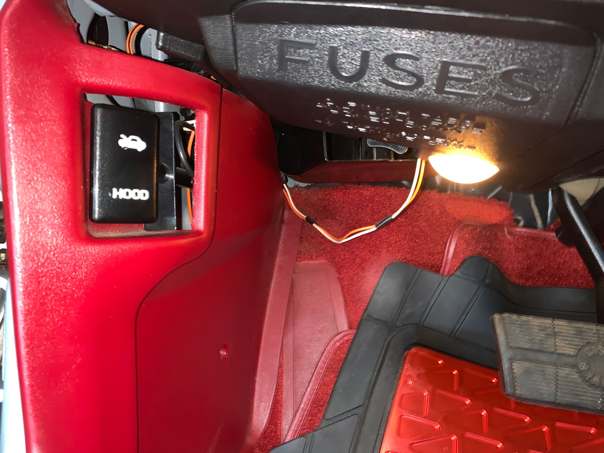

Old Aug 10, 2025 | 10:31 AM
Toon86's Avatar
Joined: Jul 2025
Posts: 115
Likes: 34
From: Ontario
Car: 1986 Base Firebird
Engine: 2.8L MPI
Transmission: 4 Speed
Axle/Gears: 3.42:1
Re: Accessories not working
Remove the fuses cover under the steering wheel on the left side.
The CTSY fuse is in this location.

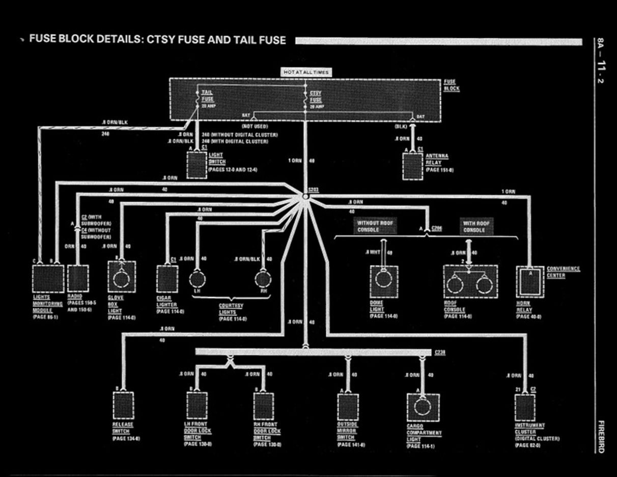

None of the items that you described as not working on your car, are controlled by the computer. Which means the computer has nothing to do with this issue.
This is from the 1988 service manual.
