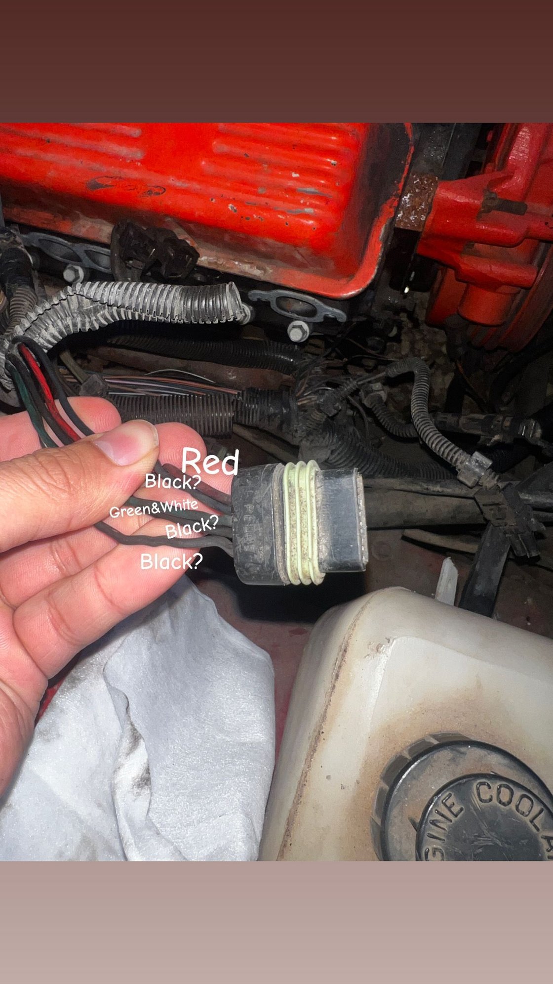

I got my Camaro back unfinished from an engine rebuild so my sensors are off and all my connectors are disconnected. I’ve looked at diagrams and either I can’t understand or I can’t find the right one cause it just seems like wires are not matching. Can anyone help me identify these connectors

Unfortunately I need you to take some more pictures of those Connectors.
In most of the posted images, your hands are obstructing view of the Connector that you are holding.
Please hold on to the Wires, so that the Connectors can be seen unobstructed in the pictures.
Also please list the wire colors that enter each connector, it will make them easier to identify.
a/c pressure switch at compressor
Tcc plug rear of transmission driver side
cts front of intake
ops next to distributor
icm to distributor
maf 🤷‍♂️
what year and engine/infuction ?

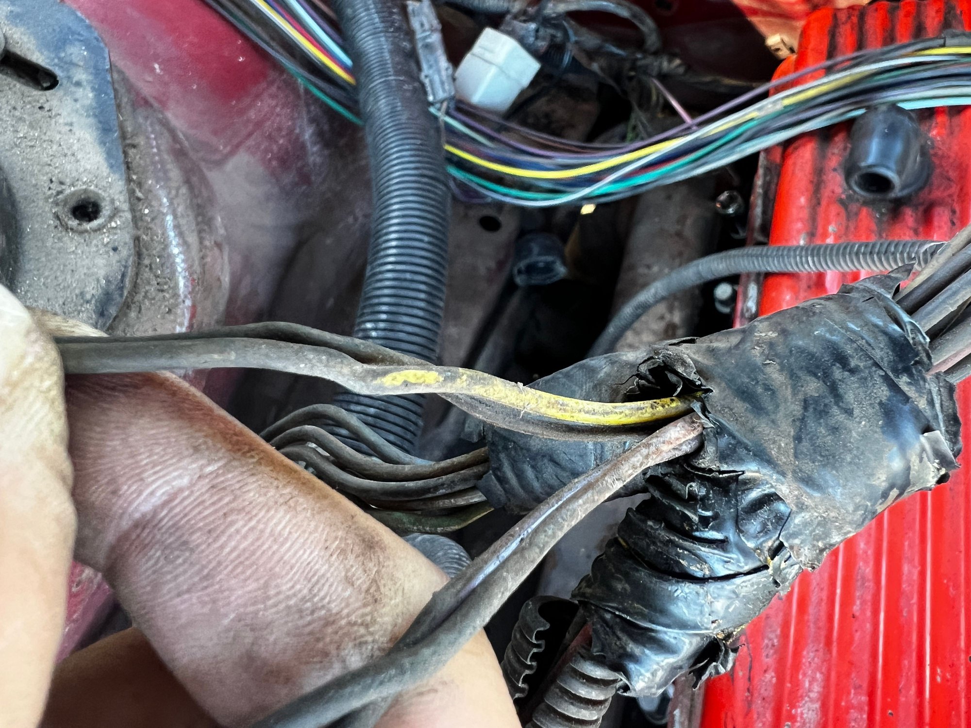

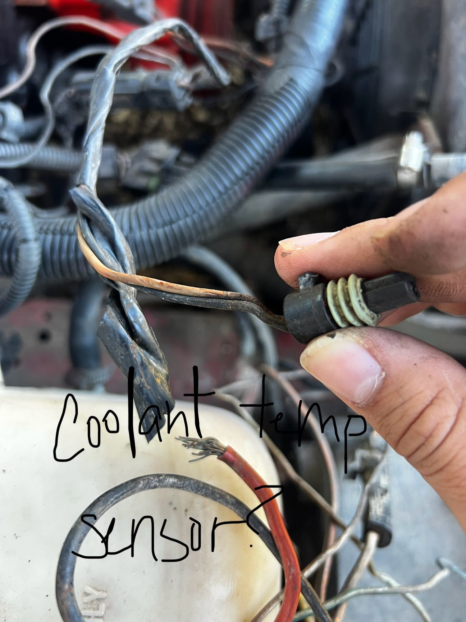

Here’s some more better pictures of the connectors I need help identifying

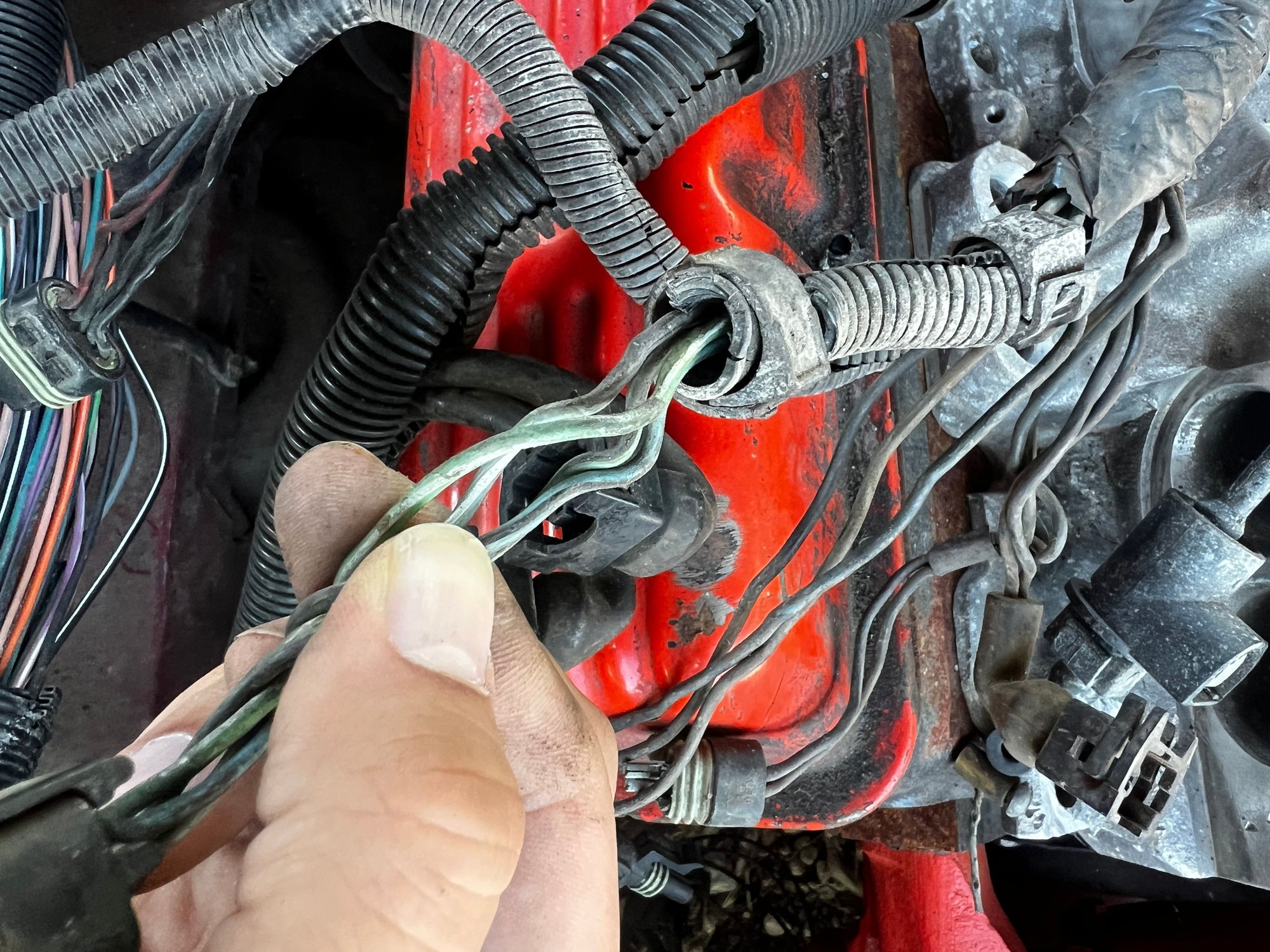

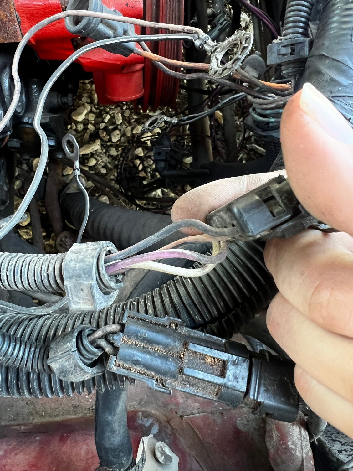

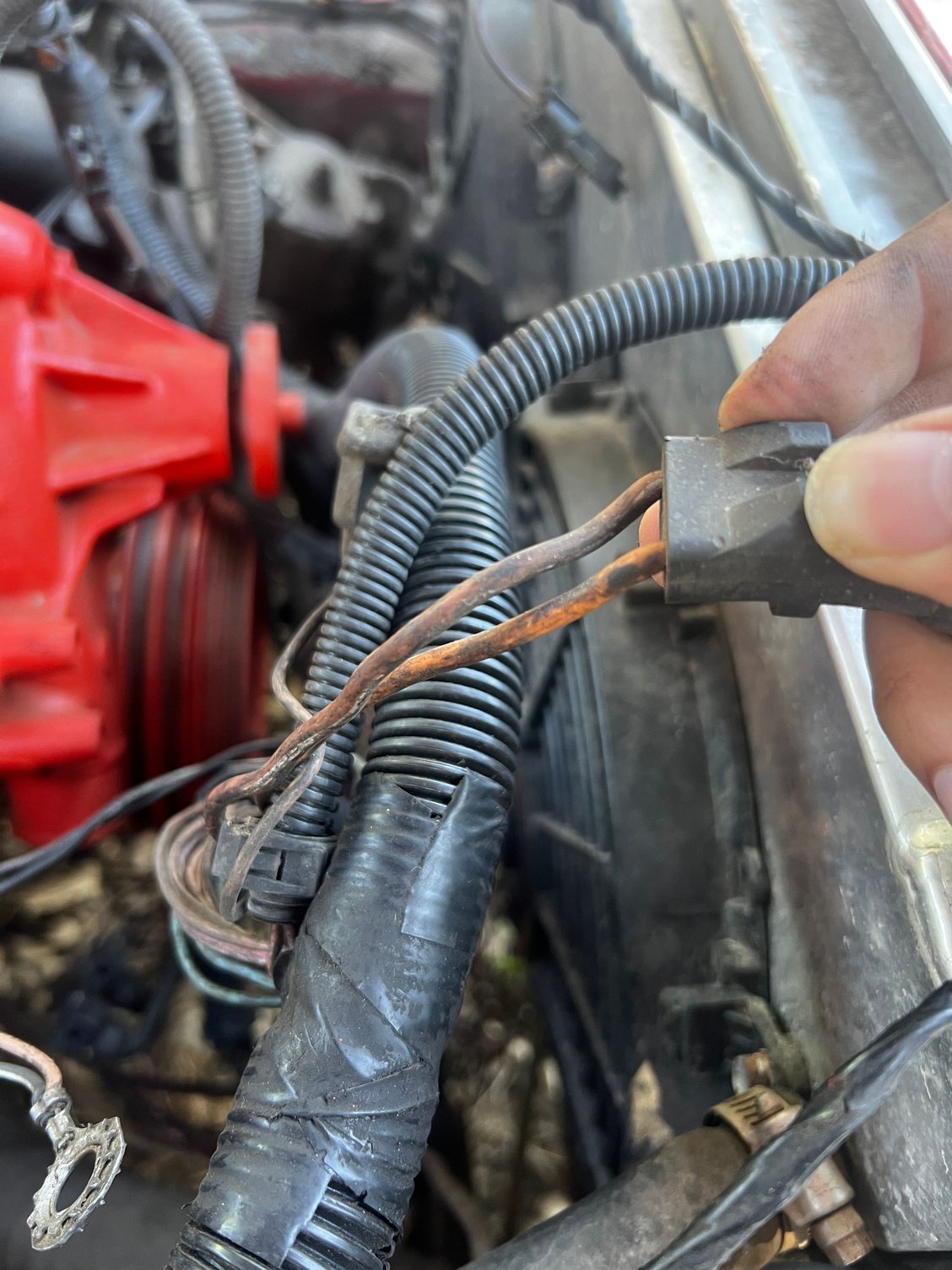

And more

Old Dec 17, 2025 | 01:19 PM
Posts: 16,852
Likes: 1,011
Re: Wiring connectors
Might want to post just the ones not identified. eBay has a packard pin tool so you can replace the iac plug. The CTs is pull to seat you can get a pigtail to repair it .

Btw, I’ve identified a few in the previous response.
the blue wire is knock sensor, not all your connectors are used. The one is csi or also called 9th injector
