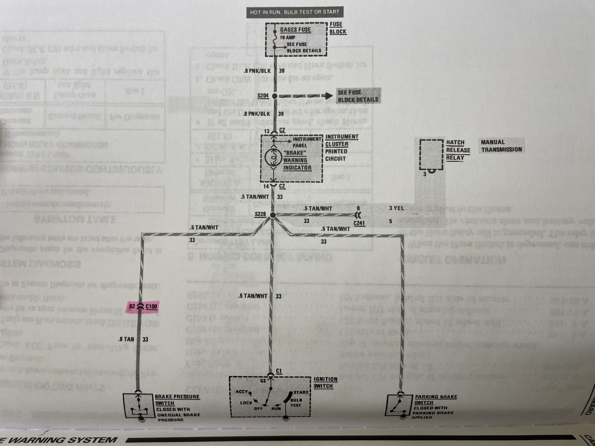

According to my "Brake Warning System" schematic, there are three things that will ground and turn on the brake warning light. 1. Brake pressure switch with unequal brake pressure, 2. Ignition switch in "bulb test" and 3. Parking brake switch when the parking brake is applied:
1. At the moment, my brake pressure switch wire is disconnected. All wires from the C100 are currently out of my car The brake pressure switch is pinned at B2 in the C100 connector. With the wire not connected to the B2, I wouldn't think that I'd get a ground
2. At the moment, my steering column is out of the car as I'm finishing up clutch pedal and neutral safety switch wiring so there should be no ground coming from the ignition switch.
3. I've got my center console put back together but I'm going to have to take it back apart. When I was playing with the parking brake switch, it seemed to be all metal. In other words, metal to metal. It appeared to me like it would be grounded no matter what position the parking brake handle was in. I'll look at it again.

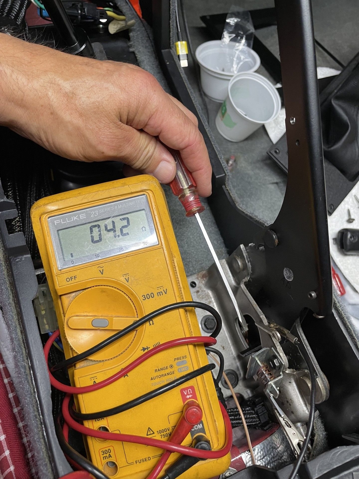

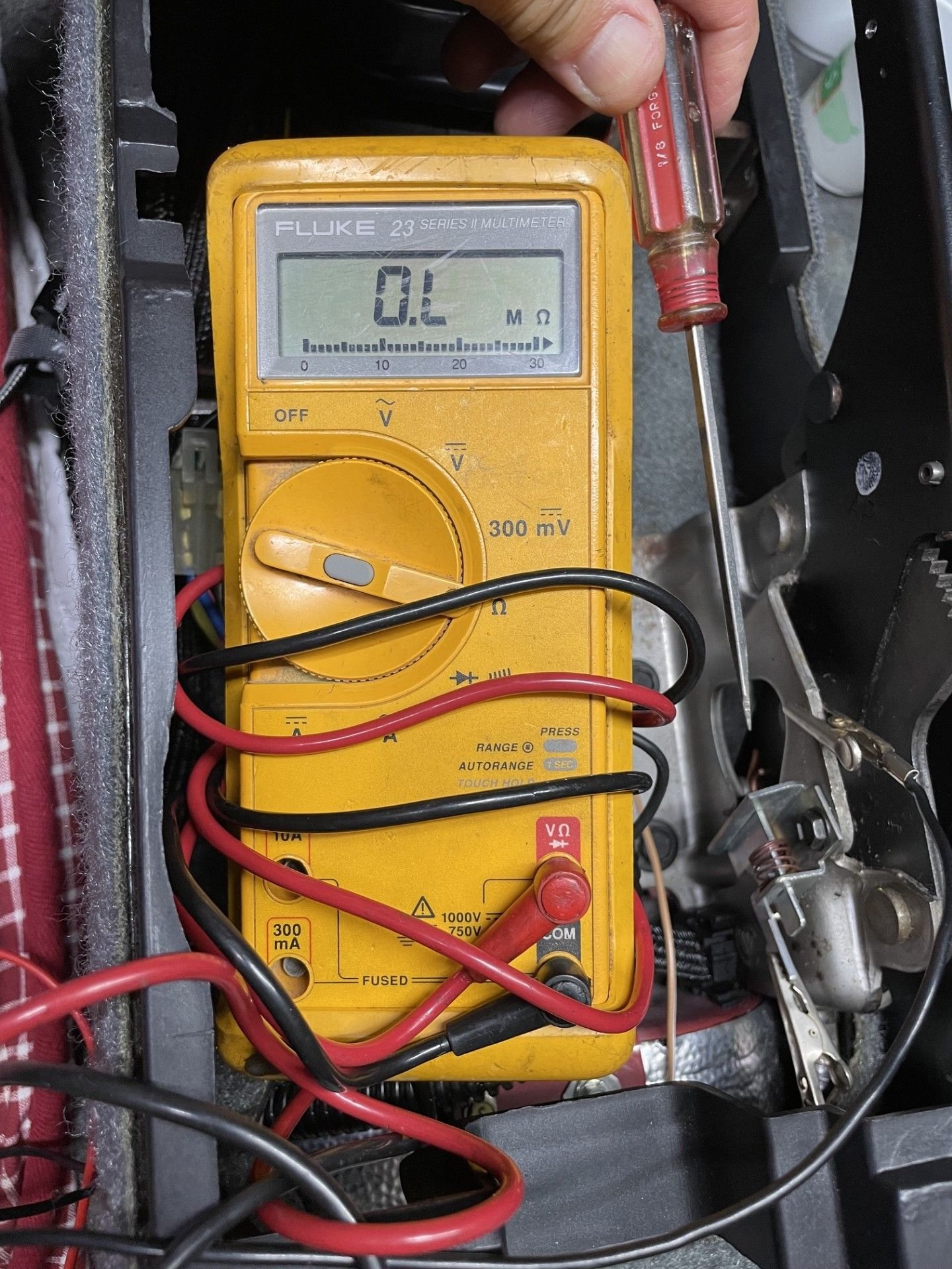

I took my car's center console back apart today to get to the parking brake switch and see what I could find while using my multimeter. I had previously mentioned that the switch was connecting to ground when the handle was up or down. What I found was that the switch was always "closed" and causing a ground. The switch is held on by one bolt and there is some play there. I moved the switch and tightened it back down and now it works like it should.
This is the reading now with the parking brake handle down.
This is the reading with the parking brake handle out of the stowed position.

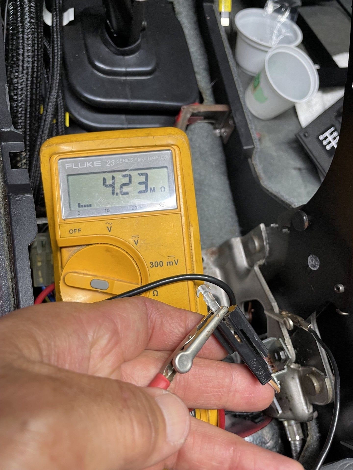

When I check continuity between chassis ground and the parking brake switch wire, I get this on my Fluke meter:
4.23 million ohms.  It should read 0L
4.23 million ohms. It should read 0.L but maybe this is close enough ? What do you guys think? Will this be enough ground to erroneously trigger my brake light?
So the switch is now working like it should so at least I made some progress.
THIMK... use your knowledge of simple electricity... 12V through 4.3 Mohms = ~ 3 ľA. 3 MILLIONTHS of an amp. No incandescent light bulb will light VISIBLY with that little current passing through it. So yeah, even though it doesn't quite read OL (OverLoad; which is not really an "overload" for ohms, butt since the ohmmeter function on a DMM is actually a voltmeter in parallel with a current source, then if the voltage developed across the impedance under test exceeds the voltmeter's range, then it reads OL) it's PLENTY close enough.
So, you've got the schematic. There's 3 things that can light the light (sorry, I forgot about the Start "bulb check", which does the same thing to the Brake light that it does to the Temp light or gauge), plus the hatch release which relies on the grounds from those 3 things to disable the hatch from opening, so unplug all 3, and pull the hatch relay. Might need to take the tan/white out of the ign sw plug and plug the plug back in so that it can work all the rest of its functions. If the light doesn't light then the wiring and whatnot is all good. Plug each of the other things back in until you find which one lights the light. Then at least you know what you need to be working on instead of being in "maybe it's this maybe it's that maybe it's the aliens again" territory.
