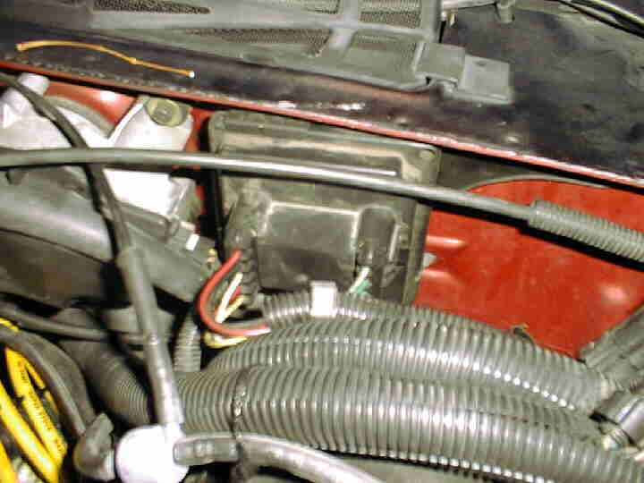

If you have the all in one headlight modulator that was my problem. The modulator was shorting inside causing voltage problems and erratic headlight operation. New one from E-bay fixed it. Only after eliminating all the other variables you mentioned. Good Luck!!
