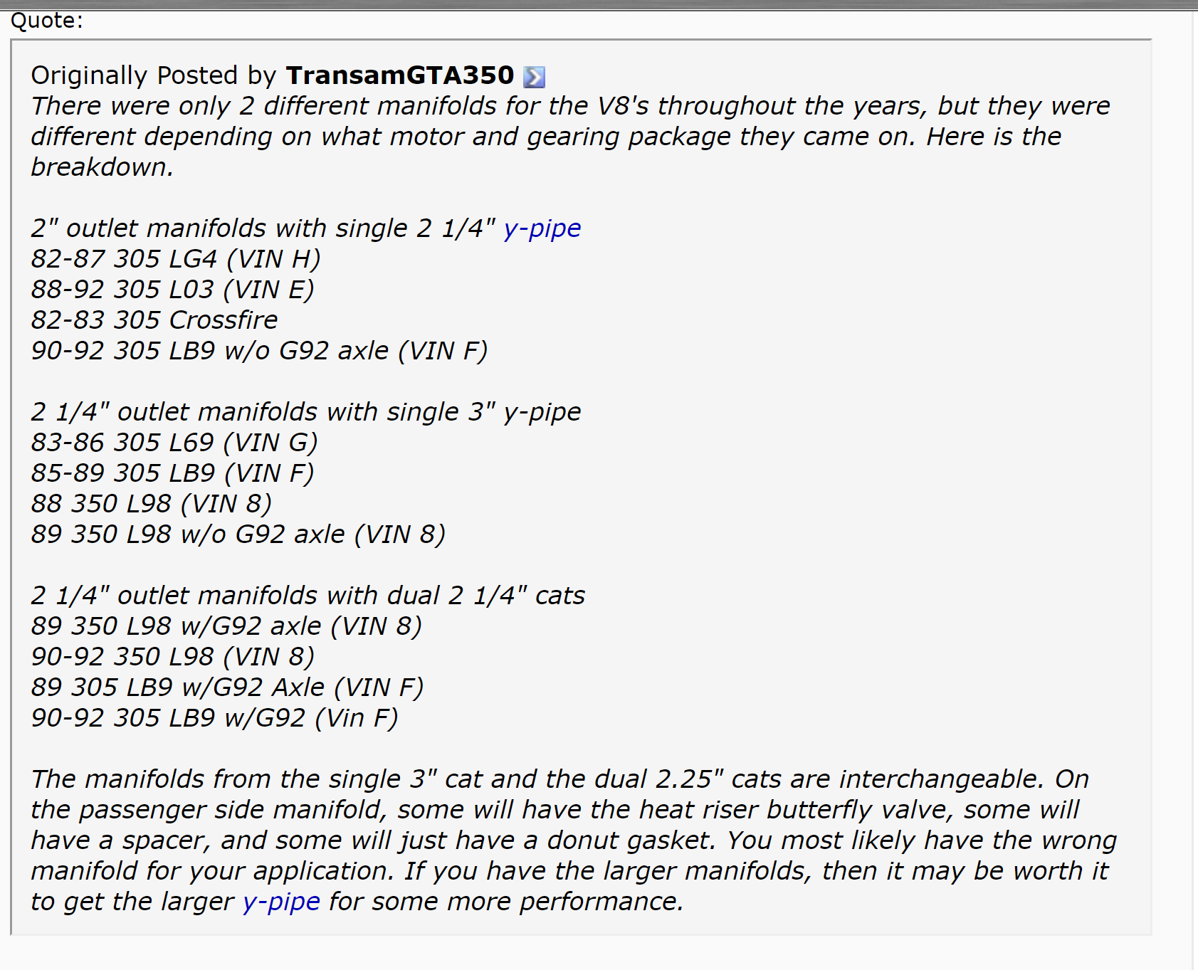

Thanks that was the thread I was looking for! Yes, your 89 LB9, like mine, has the 2-1/4". I put them onto the L98. If you had the 1990, then no, it would have the small, TBI ones.

Tootie Pang, who is the author of the description you posted? How do you know it is the definitive word, on the manifolds?

It's the same thread BlackSunshine linked.
