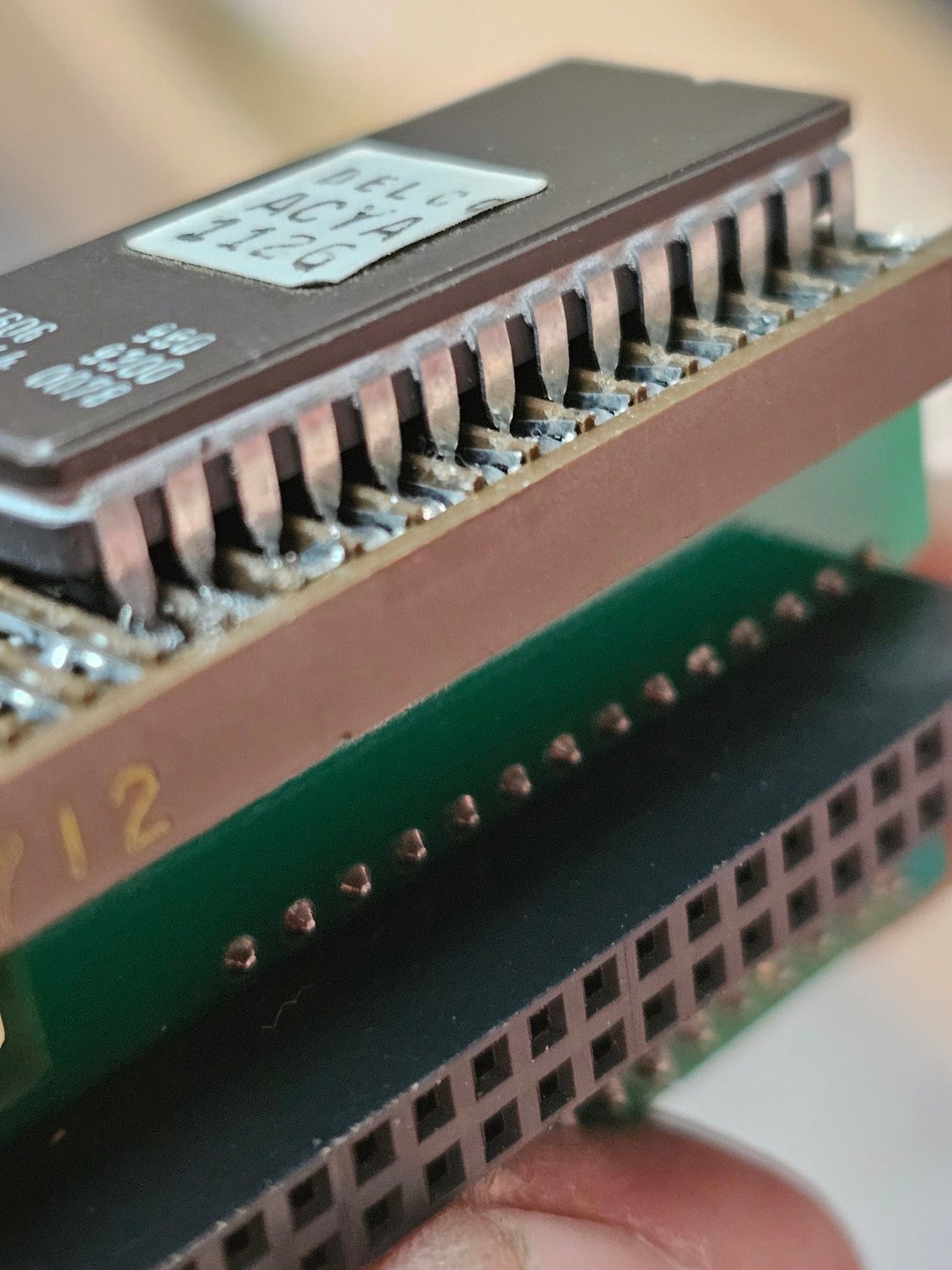

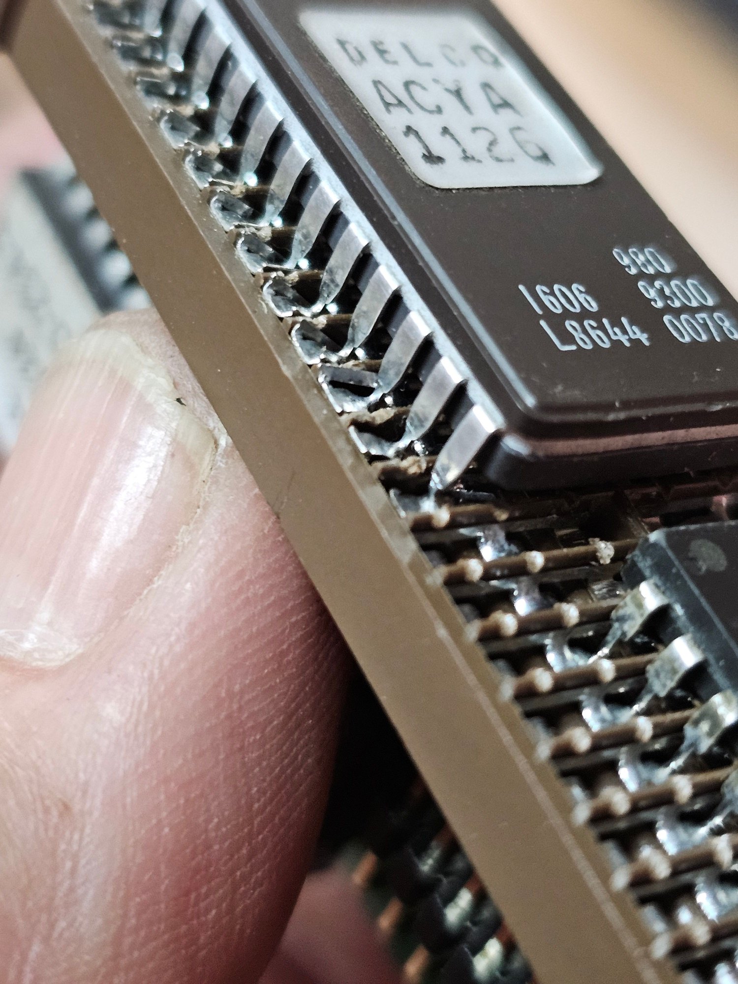

From the bbc print out I have, the only other memcal compatible is the acxz. There's others close, but different gear ratios or some other small differences.
but here's my latest stumper-
I took off jetperformance and put memcal back in as "stock" and sel light came on instantly (battery was disconnected) and i could not ground a&b terms to put in service mode. 3 different ecms and same on all. 1500 rpm, could not idle down. Backed screw all the way out, to not touching. Dropped only when ac turned on. Down to 1200. Throttle response was great, none of my previous issues were present.
put jetperformance back in.....and I could ground aldl, sel light went off, idled around 850 fine...but My issues returned as if I never took the jetperformance off....

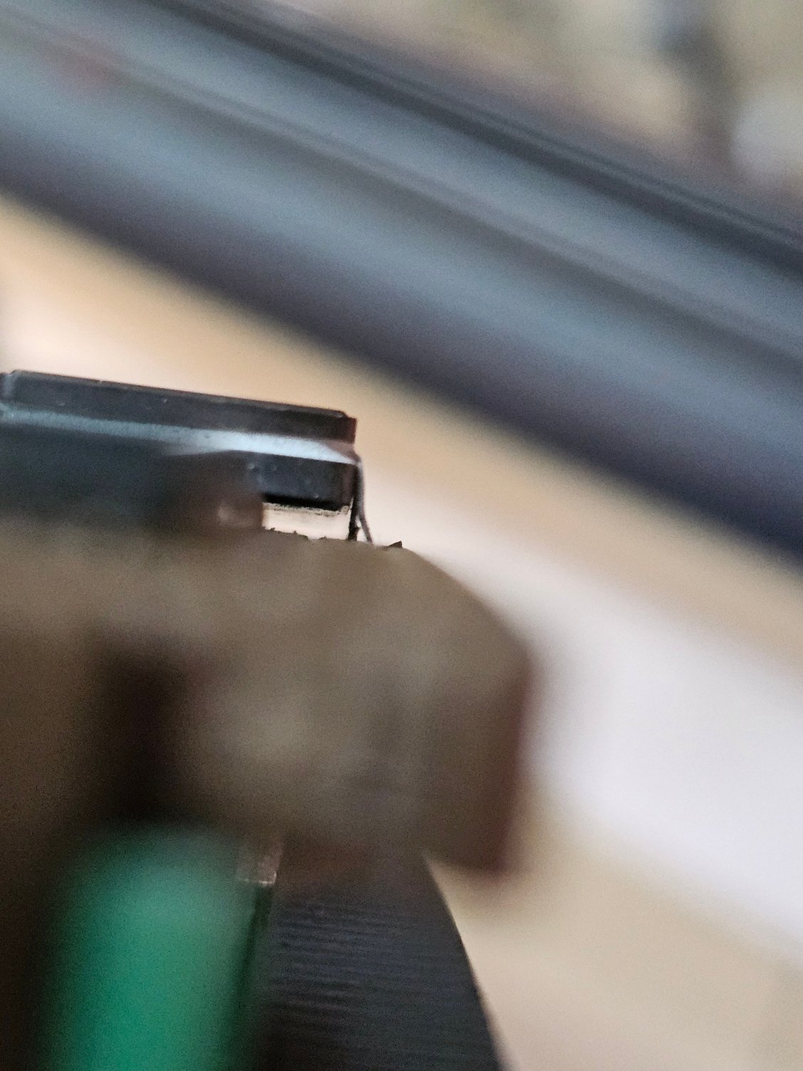

I can sent pics of mecal and the prong that I bent. I did take dental pic and slowly, softly, carefully tried to make it right. I just dont understand why it wouldn't go into service mode when "stock, but would when jet chip put back in....

The jets was a piggyback and you still have a memcal ? Not even a code 41 or 51 will blink ?

Yes, the jets is a piggy-back. I do get a code 42, but no sel. The circuit isn't grounded, did the flow chart, and the ignition control module is new. On the 3rd one actually. I'll be rechecking here shortly for grounded circuit

You could always try soldering the legs to the pins. or this is a good deal.
