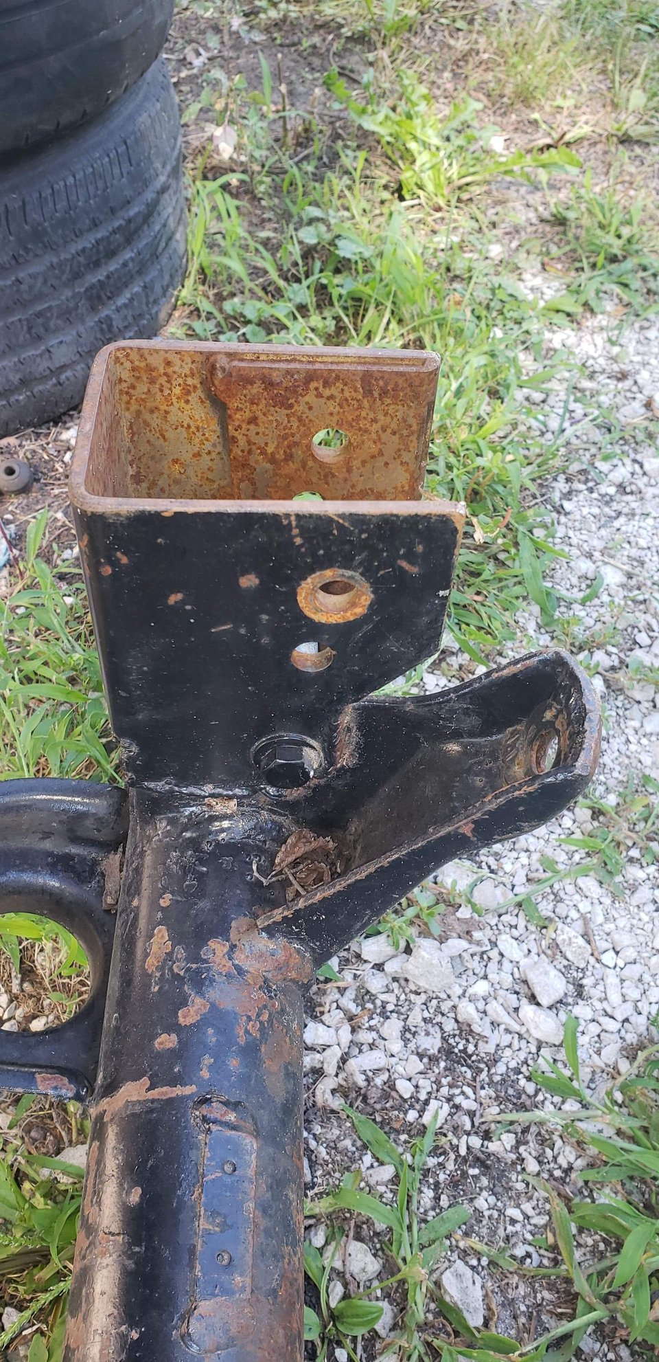

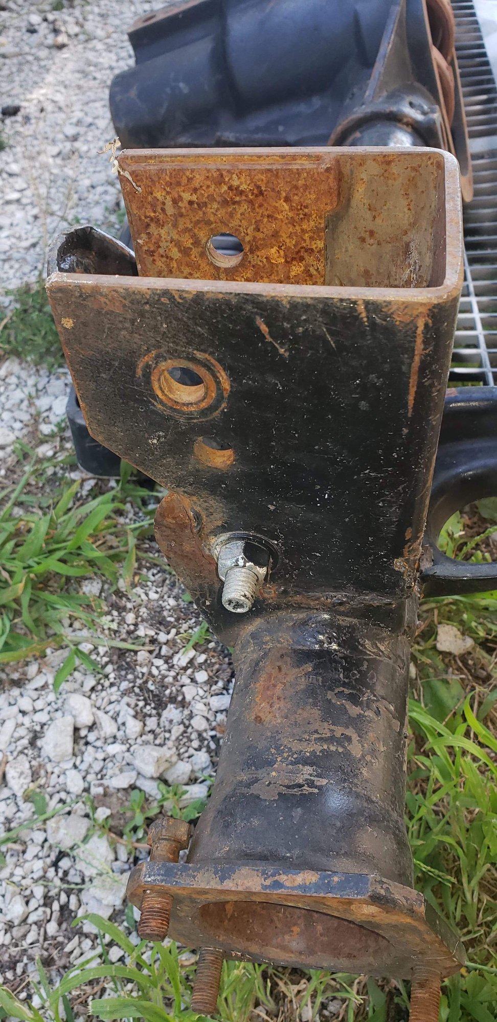

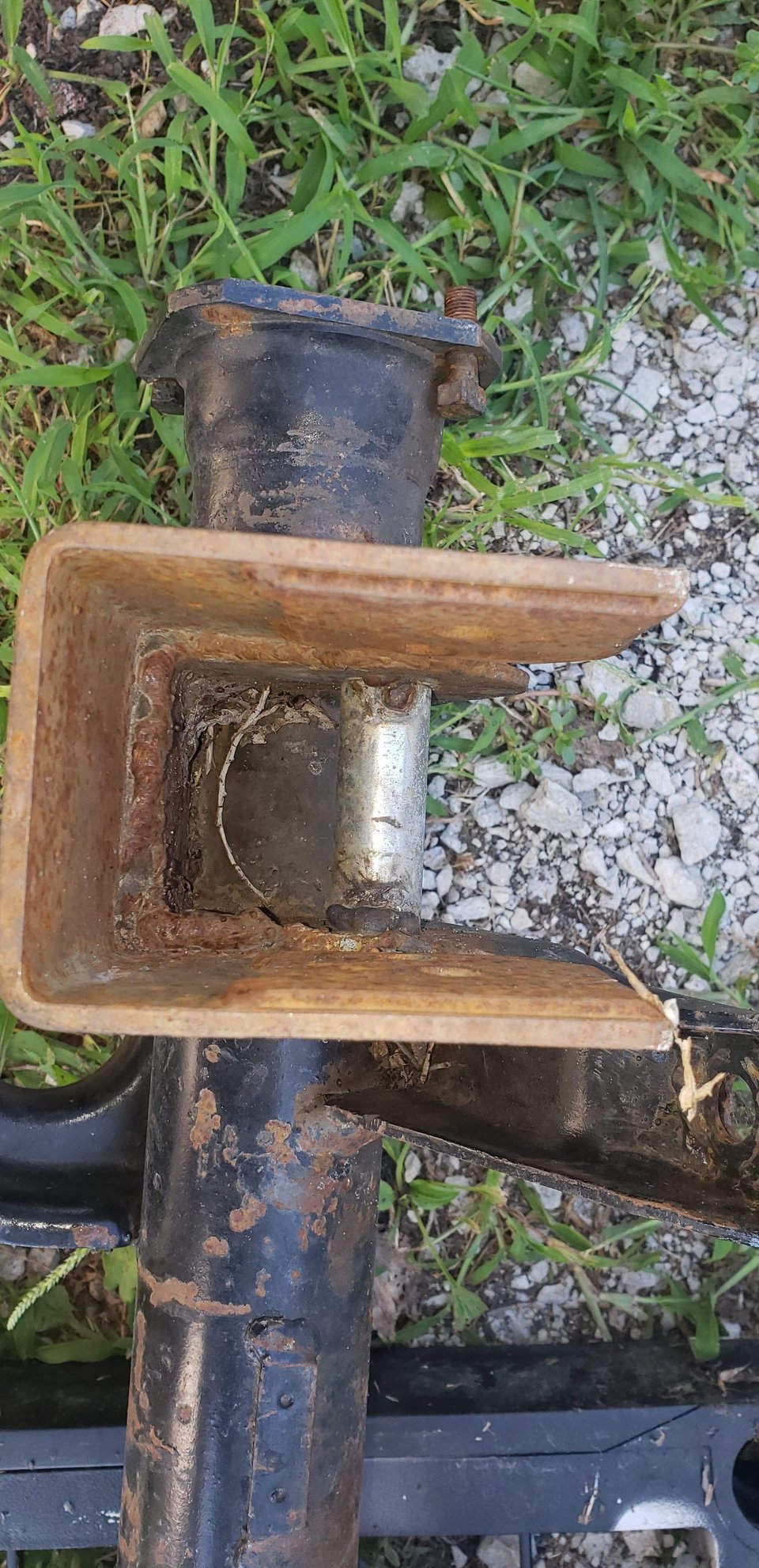

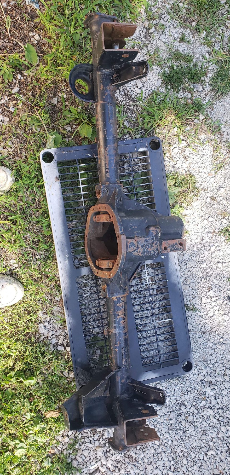

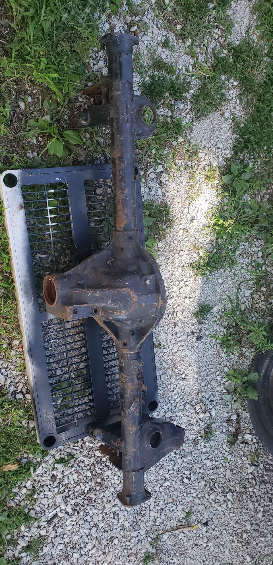

Dana 44 parts
I am looking for basically everything for a Dana 44 other than the housing that’s all I have.
also have rear cover. Any leads or parts that will work. Pretty sure any Dana 44 carrier will work?

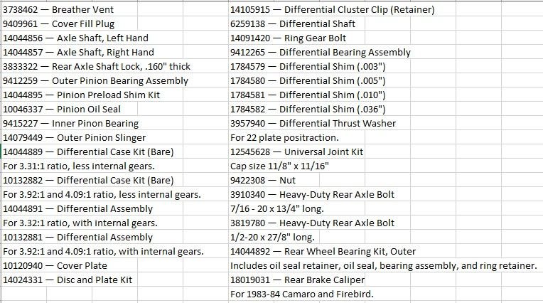

You should be able to cross most, if not all, the list of parts that GM used and get current parts to get it fixed right up.
where do I find that?
Old Feb 1, 2020 | 04:49 PM
TTOP350's Avatar
Posts: 12,229
Likes: 1,156
From: Il
Engine: 4++,350 & 305 CIs
Re: Dana 44 parts
https://www.thirdgen.org/forums/tran...arts-list.html

I found this already talking about to cross reference

I am still working on mine, but I have some of the cross numbers.
I think finding a yoke and axles will be the most difficult parts to get. I can't find a catalog replacement for the yoke, yet. I would like to get something forged, but I what I have will work for now
I also want a true track for mine. I am almost tempted to sell you my carrier now with the gears I have

Should be fairly easy to cross those with google or any parts store. Maybe even spicers tech department could help. Think moser may still have axle info to make new ones.
