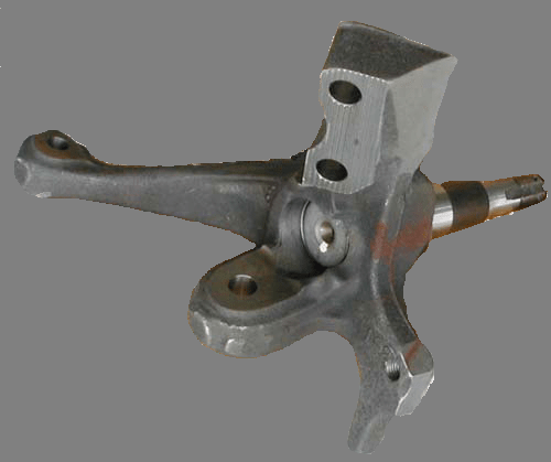

I found those Hawks units about a year ago. I have ordered a few things from Hawks over the years.
I brows their catalogue of parts for our cars when killing time. Wondering what I can get from them.
There are other threads on TGO questioning the quality of the castings. Don't remember/am not sure what the bases of questioning the quality was.
All I know is that they are not made to the OEM shape. Specifically they don't have a steering stop, the small ear that protrudes down from the spindle that hits your A-arm.
This is a mechanical steering max limiter that I don't want to go without, and frankly if they missed this, I don't know what else is wrong with them and that prevented me from considering them.
If they corrected this issue, then maybe I would consider that options.
As things stand now, I only see old OEMs as a viable option that I know won't have issues like this.

Hawks spindles are designed for the bigger calipers that wont fit with the steering stop.
I did that mod to my original one's to fit the 4th gen brakes. Great upgrade!

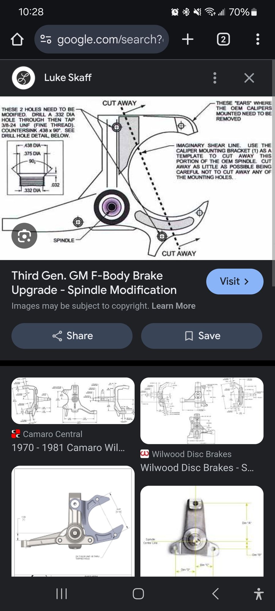

This doesn't make sense.
I did the mod to my originals back in the day. This is what I did. The steering stop is preserved.

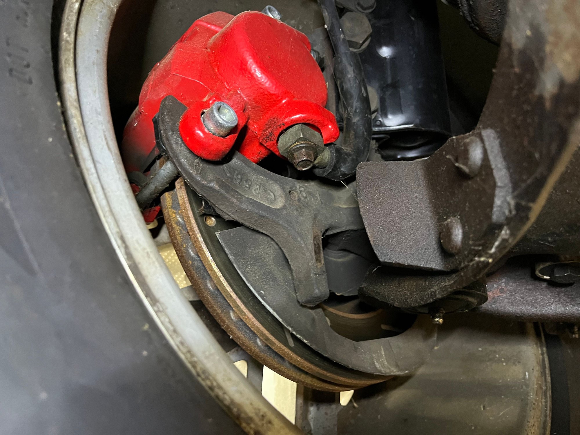

You are correct. The steering stop is retained.
It's been years since I did the mod.
Picture is from Big Brake Upgrade where I purchased the brake kit upgrade.

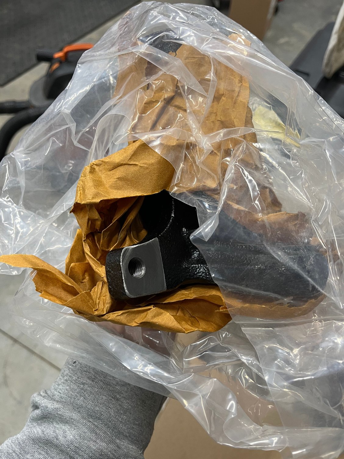

I just checked and unfortunately they do not have the stops, they look the same as the hawks ones. They are a relatively new offering and I think they reused the picture from another model, as the caliper bracket is different as well. (L shaped).
That being said the kit was 20% off on black friday and was cheaper WITH spindles than the hawks 1LE kit was without them. So I couldn't pass it up.
