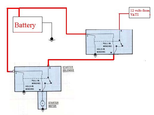

First where did you plug the alternator wire that recharges the battery ? this cable cannot be plugged on the battery, it needs to be plugged somewhere on your harness "for exemple the ceramic power distribution thing beside your radiator."
Also , where's your main ground ??? , it really needs to be on your engine block, with a CLEAN connection. also the chassis ground connection needs to be on the passenger side fender near the battery.
Have you played in your fuse box ? anything that's not working anymore ? Also you said you unpluged the buzzer for the lights, doors and key ? why ? was it always on ?
Is your starter enable relay correctly plugged ? (located in the driver side kick panel)
you also stated that your starter's not getting 12 volts ???? is your battery charged ? because it's pretty straight foward, positivite from your battery that goes to the starter, ground from battery to engine block, posivite from battery goes to "enable start relay" enable start relay goes to solenoid of starter.
Anyway check that out and give us a better description of what's wrong, what's not working, what you did to it once it ran for 45 minutes.

Scuse made a mistake in my cheap diagram !
