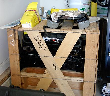

hey RICH92RS350 i think i bout the same crate engine as you.
My roommate works at a GM dealership and they bought the wrong engine for a capri so i was able to buy the engine for real cheap.
I wanted to know if there is anything i need to do to get this engine to work in my car. My 87 IROC already has 350 TPI in it. Being that this engine is for a 93-newer car will there be any problems with swapping it into my car...what about a new chip? I am going to put the engine in the car in a month so i have plenty of time to get any parts i need. the car doesnt run anyway... so what is another month.
Thanks for any info you can give.
Mike
EDIT
ohh yeah...the crate engine has Center bolt valve covers...as does my IROC...dont know if you needed to know that info or not
Is that the engine that you bought? -->
