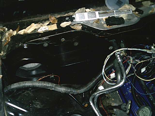

taking my the A/C condensor box out was one of the best things i did. I swapped a V8 in, and wasnt going to use the A/C and I got lucky and found a non A/C car in the junkyard. the non A/C heater bolts up to the same place. There is alot more room, which you can kinda tell by the pic. i can get a better pic if you want.

So the non ac heater box was a direct bolt on, i may just do that! thanks I always hold onto my stock parts. Now they are taking up a lot of room, i'll have to figure something out shortly. I keep my stock parts so that if i sell the car i may get more money for it in the future, way distant future that is! lol I guess we'll just have to see. thanks guys
