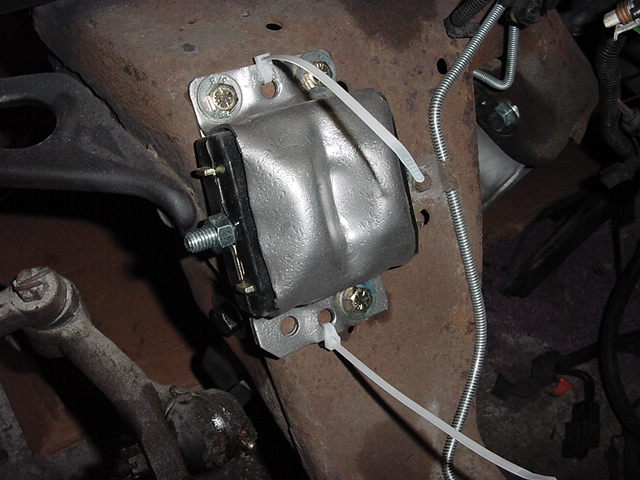

These are the holes mine were originally in...

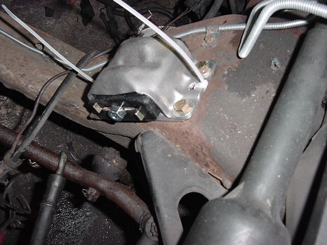

And the passengers side...

So why won't they work in that position? Th e only time ya move the mounts ar in a v-6 to v-8 swap...then you move them to the forward most set of holes...or BB- swap and so on...a SBC is A SBC...as far as mounts are concerned..

The pics were just to show where mine originally were when I pulled the l98 from my car. Thought they may help.
