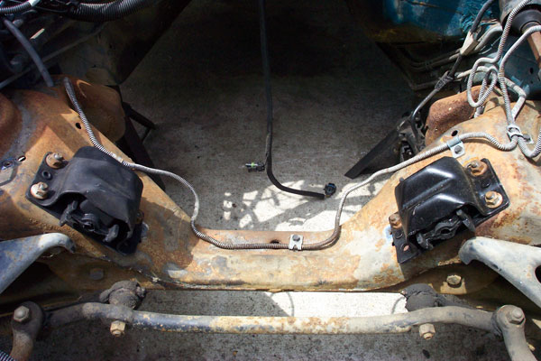

BigDreams92's Avatar
Joined: Aug 2005
Posts: 294
From: Middle GA
Car: 1992 RS
Engine: Vortec Headed 383 9.6:1
Transmission: TKO600
Axle/Gears: 10 Bolt Posi 3.73
This is a pic of the v8 mounts in the right location with the brake lines bent back around them. If it was originally a v6 chances are the brake lines are going right between the holes you need to be using.
As for bolting them down and taking them off, you can get to them with out dropping th A-arm. It just takes time, patience, and some swivel head sockets.

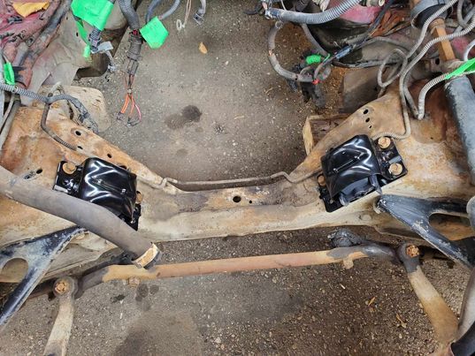

Old Oct 22, 2023 | 09:31 PM
Camaro69Guy's Avatar
Joined: Jun 2006
Posts: 11
Re: Problem vith relocating motor mounts (V6 to V8 swap) - holes won't line up
I realize this thread is ancient now but I have to ask, how did you manage to bend and route the brake line like that? Is that still the same one from when it had the V6? I'm doing that same swap and am leery about bending the brake line or even using it for that matter. From what I am trying to do, it seems like if I get the mounts where I need them, the part that goes across the crossmember will be interfering with were the exhaust will run behind it. In your picture, it almost looks like your brake line has been flipped around.
It's not as difficult as you think, and the exhaust is nowhere near it...

I have been told that by a guy on YouTube as well but I've never been comfortable working with brake lines. What I tried to do today seems like it would work with just simply moving the brake line back enough until there is room for the mounts but then the part of the line that goes across the crossmember is basically in mid-air so I feel like I must be doing something wrong lol.
No part of the brake lines should be "in mid air". Can you post a picture?...
Old Oct 22, 2023 | 10:23 PM
T.L.'s Avatar
Posts: 3,047
Likes: 826
From: Colorado USA
Car: '83 Firebird (T/A Clone)
Axle/Gears: 10-bolt/3.73 ..
Should look like this:
Attached Thumbnails Problem vith relocating motor mounts (V6 to V8 swap) - holes won't line up-20190614_152651.jpg
Old Oct 22, 2023 | 10:38 PM
Joined: Jun 2006
Posts: 11
Will take a picture tomorrow and figure out how to post it here, lol. Getting frustrated with this project honestly.
Also found out that the bolts from my V6 engine mounts are too short to use on the new Camaro V8 mounts. Short by about 1/2" so that makes it frustrating too.
The engine going into the car is from a '98 Silverado so the engine side of the mount is still from the truck.
Old Oct 25, 2023 | 06:08 PM
Joined: Jun 2006
Posts: 11
Finally managing to post these pictures.
This is just unbolting the line brackets and moving the line back. No bending as of yet. Also, for some reason, the driver's engine mount seems a little crooked but the bolts aren't tight. Just set there. I might have to tweak the hole if need be.
