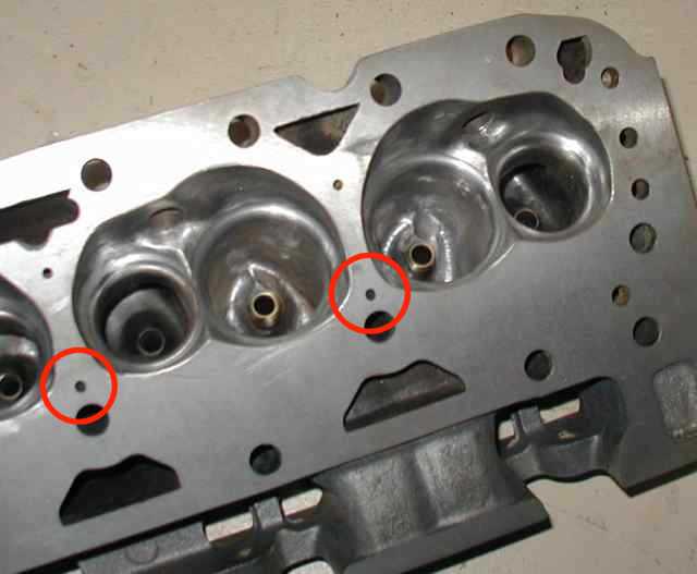

Well it is a good choice I must say. But it will require some work, as the Trans from your car will not work with a V8, so you will be looking at getting a new trans, and make sure that what ever heads are on the 400 sbc that you drill out the appropriate Steam holes. Here is a pic that RB83L69 posted once. it has two of the 4 steam holes circled. The two circled need to be drilled on a angle. You will need to get some 400 sbc head gaskets, these will allow you to mark any heads without them with a center punch, and make sure what ever head you use have these holes. The two holes on the exhaust sid eof the head are just drilled straight in, the tow hole on the intake side of the heads are drilled on a 45 degree angle towards the exhaust side.
