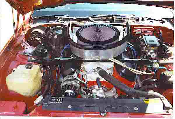

I got a 454 for my malibu, plans for an 8 second street ride, your going to spend a lot more money on a 427. but if you just stay stock, you could probably be patient and find out complete I'm shure for a grand tops. good motors. but the differnece is that more parts are made for a 454 than a very odd 427. my big block revs out at 6700 rpm. put a good roller cam in there. tell you what, just put 427 valve covers on a 454
but I know where ur coming from, I wanted to put a 327 in my malibu, till I woke up one day with a goal of 8 seconds
Old Apr 15, 2004 | 05:51 AM
greezemonkey's Avatar
iTrader: (14)
Joined: Jan 2004
Posts: 1,761
From: The "D"
Car: A Portly 85 Z28
Engine: 4.530 X 4.250 BBC
Transmission: under rated for this application
Axle/Gears: also under rated
Mines a daily driver
http://www.cardomain.com/memberpage/487725

here`s what I did about the steering pump, it`s a divorced pump, it can`t get a long with the resivor it came from a 85 s-10 with a L-4 iron duke. the small block pump pulley sat right on the gear box.
