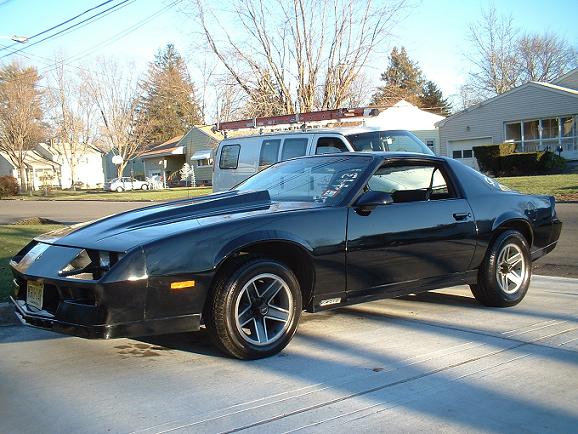

this is how high the car sits as of right now. i can reach almost to the middle of my car by gettin under the middle of it by the door.
