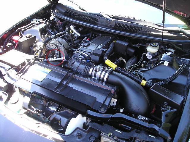

I will have to dig up a pic. The car is in storage so I can't get to it easily. I only noticed that there were two screws when I bled the system a summer ago. There were two bleeder valves around the thermostat (been while and can't even remember where they are) that are about a few inches apart from each other. Apparently you can bleed one effectivly or tyou can do a two step process. I didn't really look into it much past that but I can see I need to now

Here is a pic. You can see the one bleeder screw in the line there. I am not sure if people include this in their swaps. If they do then they have 2 bleeders.

Ahhhhhhhhhhhhhhhhhhhh, yea, that crap ain't on my car. The waterpump itself has a bleeder, only one I use.
