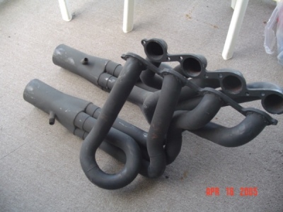

Heres a trail fit of the LEMONS HEADERS 2.250. Before painting engine bay again & again..lol
Rotten
Pic dint upload?

Old Mar 19, 2005 | 04:57 PM
  #60
zrotten's Avatar
Posts: 45
Lemons
Check out the collecters, you can see the first coat of metalic spray before the red went on.
Rotten
PS puts those "hookers" back in the gutter.......lol

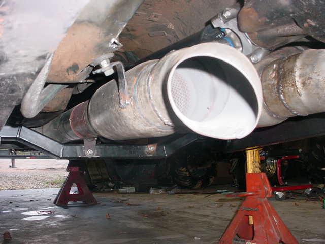

How about pics of the whole exhaust
Old Mar 19, 2005 | 06:35 PM
  #64
zrotten's Avatar
Posts: 45
I can show you a bunch of tubes!
I have all the pipes laid out. Im in the middle of installing a k-member-arms and rack. Each pipe is seperate then they go in one at a time while theBBC is in the car.
The headers all run down the trans tunnel, unlike the Hookers with that restrictive 3" u-bend. I also have my frame tied in there and the hookers just made it hell to go to 4" I'll show you a test fit to give you an idea of the two fenderwell pipes.

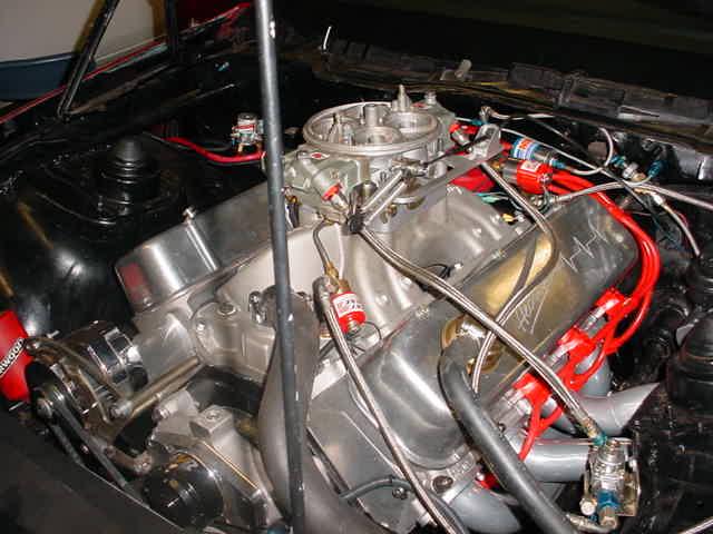

here's mine.
Attached Thumbnails BB Engine Swap Header-c-documents-settings-owner
Old Mar 23, 2005 | 09:20 AM
  #68
onefast85's Avatar
Joined: May 2004
Posts: 161
From: texas
Car: 85 camaro
Engine: 605in bbc
Transmission: powerglide
Axle/Gears: 12bolt with 4.10's
middle 2 tubes on both sides go through the towers and all tubes meet in the same place as the hooker collectors used to be.mine were built by a local chassis shop.2 1/4primaries and 4 inch collectors,4inch exhaust to race magnum 4 inch mufflers turned downed tight in front of the rearend.
the reason mine are built like this is ground clearence.for me its too tight there to run the 4 inch between the trans and frame rails and then the trans crossmember is all in the way.mine never rubs the ground it is tucked way up in the car as high as i could get it.

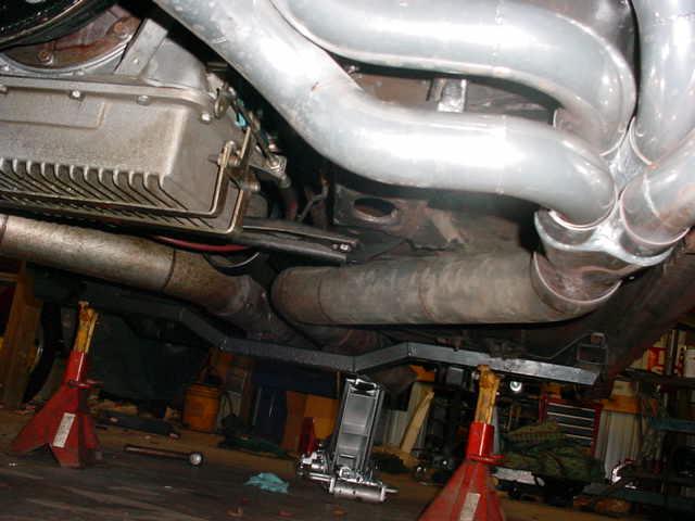

exhaust

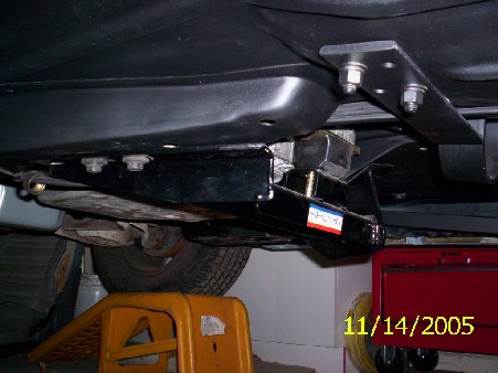

Hey onefast85, is that a SSM Lift Bar setup under your car?
Old Mar 23, 2005 | 10:27 PM
  #71
onefast85's Avatar
Joined: May 2004
Posts: 161
From: texas
Car: 85 camaro
Engine: 605in bbc
yep,it is the southside kit.

I thought so. I bought that kit and have installed the SFCs but haven't yet installed the lift bars and crossmember. I've read good things about the kit. It's supposed to make these cars good for up to 1000 HP. Did you set your pinion angle with the torque arm installed in the stock location then remove it? Just curious. The directions give a lot of details on what the pinion angle should be, but don't ever mention "how" to achieve it.

Originally posted by onefast85
exhaust
good stuff...Do you mid posting more pics ..On the side and passenger side?.. My driver side pipes coming out off the Hooker collectors goes across under the tranny crosssmember and goes into the single 3" cat back..The passenger is a little different though

PS Solid linkage is just what it inpliesSOLID,it will wear but it will last longer

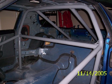

five7kid, bear with me. I know a few of these pics don't apply to "engine swap" forum, but they are a result of my engine swap.
Boo.
Spohn Crossmember:

Roll bar:
