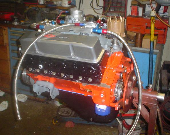

Check out the new engine
Hopefully it'll be going in tomorrow, depending on the weather.
Also, how many miles is recommended for break-in for the rings and new bearings? 1000 miles typical for moly rings?
Specs are in the sig

I pressure checked the rails, and they were leak free at 85psi for just over two hours. So hopefully no issues with fuel, but I guess I'll see what happens...
It's 90% stainless hardware too. I'm tired of dealing with rusty ugly fastners

Originally posted by f355bird
Sounds like its going to be a hot little 305. Looks great. But why spend all that money on a 305? Im sure a lot of people will ask that.
Eh, let em ask
The main reason is because I recieved this engine for free, and it was supposed to be a relatively fresh rebuild. I figured I'd tear it down anyway just to have the peace of mind. Here's the list of most of what I found wrong with it:
-Half the rings were upside down
-two broken rings
-none of the ring gaps were staggered, they were all lined up perfect.
-standard size rings on a .040 piston. the gaps were nearing .040 on all of them.
-the rods had not been line bored. Because of this the bearings were all worn very off center and needed to be replaced.
-Thrust sides on (cheapo) pistons were worn concentric to the middle of the piston walls. Almost like the pistons were ballooning out in the middles.
-the main bearings were all worn down to the copper, but was just typical of higher mileage wear.
-heavy oil buildup under all the main bearings. That's just asking for a spun bearing.
-No crush on any of the bearings. They all pretty much fell out except for the thrust bearing.
-The front two cam bearings had heavy scuffing all thru the bottom of them. Still don't know what caused that one.
-THREE freeze plugs were inside the water jacket.
Anyways, I don't know how, but the block and crank were nearly perfect. A couple cylinders were out of round by .0005", but there was nearly no taper, and no marks or scuffing that wouldn't clean up with the hone. All the crank needed was a polish and it was good to go. I think the only saving grace is that the kid I got if from's uncle is an AMSOIL dealer, so that's what the motor used.
So long answer short, the main reason was money. I am only in roughly $500 for the complete shortblock build, and the heads, intake, headers, exhaust, ignition, and everything else will swap to a 350 when funds allow.
Oh, and thanks for the compliments I'm definately proud of this one, and it's been a while coming together with it.

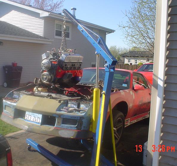

Unpainted headlight pockets make great tool trays also
Hopefully I'll get to fire it tomorrow. I gotta pick up a couple more -an hose ends, and a couple other odds and ends and then wire up my new gauge pod.
HOLY ****, i went to UTI in glendale hiegths, hahahah. I noticed that gay *** stupid sticker they make ya stick in the winshield.
