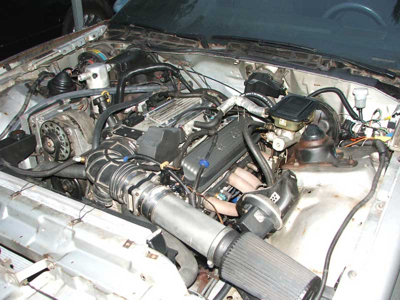

I used a stock 4th gen elbow that goes to the driver side, a piece of 3" hard plastic tubing and a K&N Cone filter on the end. Since I did away with the purge canister, I have the room to put the filter where the canister would go on a Camaro, but I moved my battery to the passenger side.
