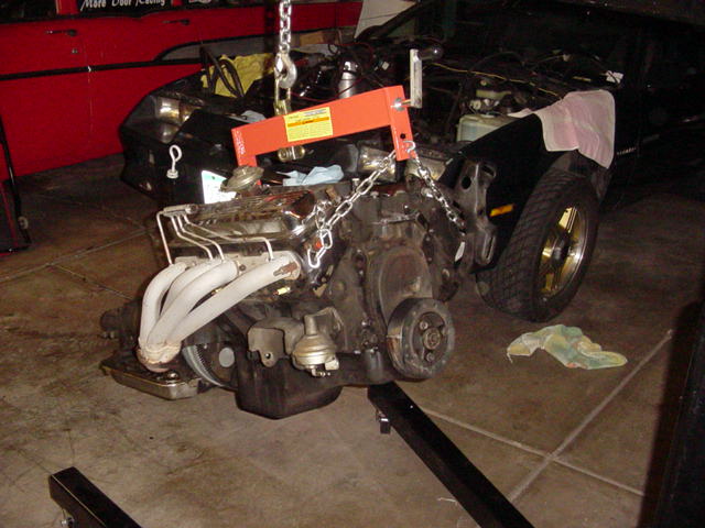

What the 305 looked like coming out.
Attached Thumbnails installing engine with headers installed-engine-tranny-out.jpg

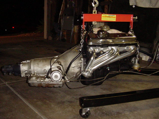

What the 350 looked like going in.
Attached Thumbnails installing engine with headers installed-350-tranny-pass-side.jpg
