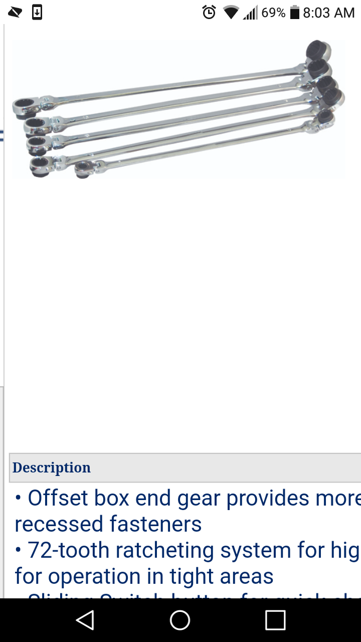

Re: Motor mount installation tip
I used these. Work great.
