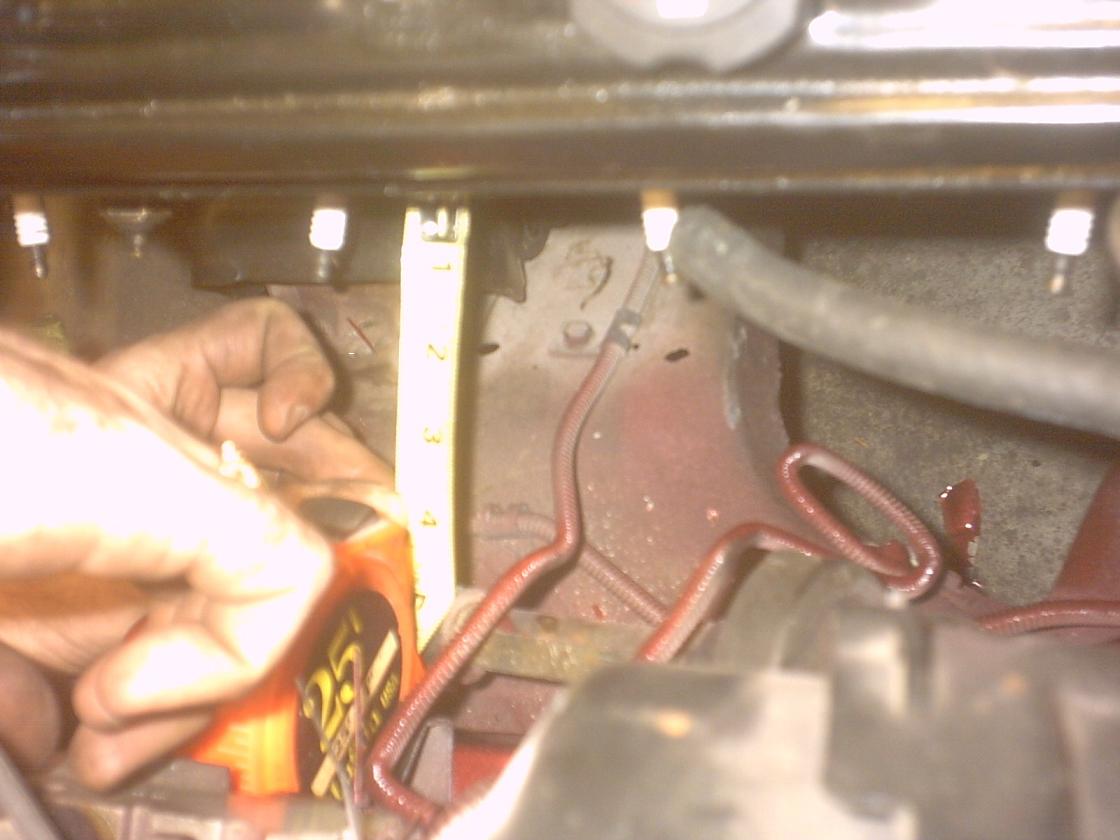

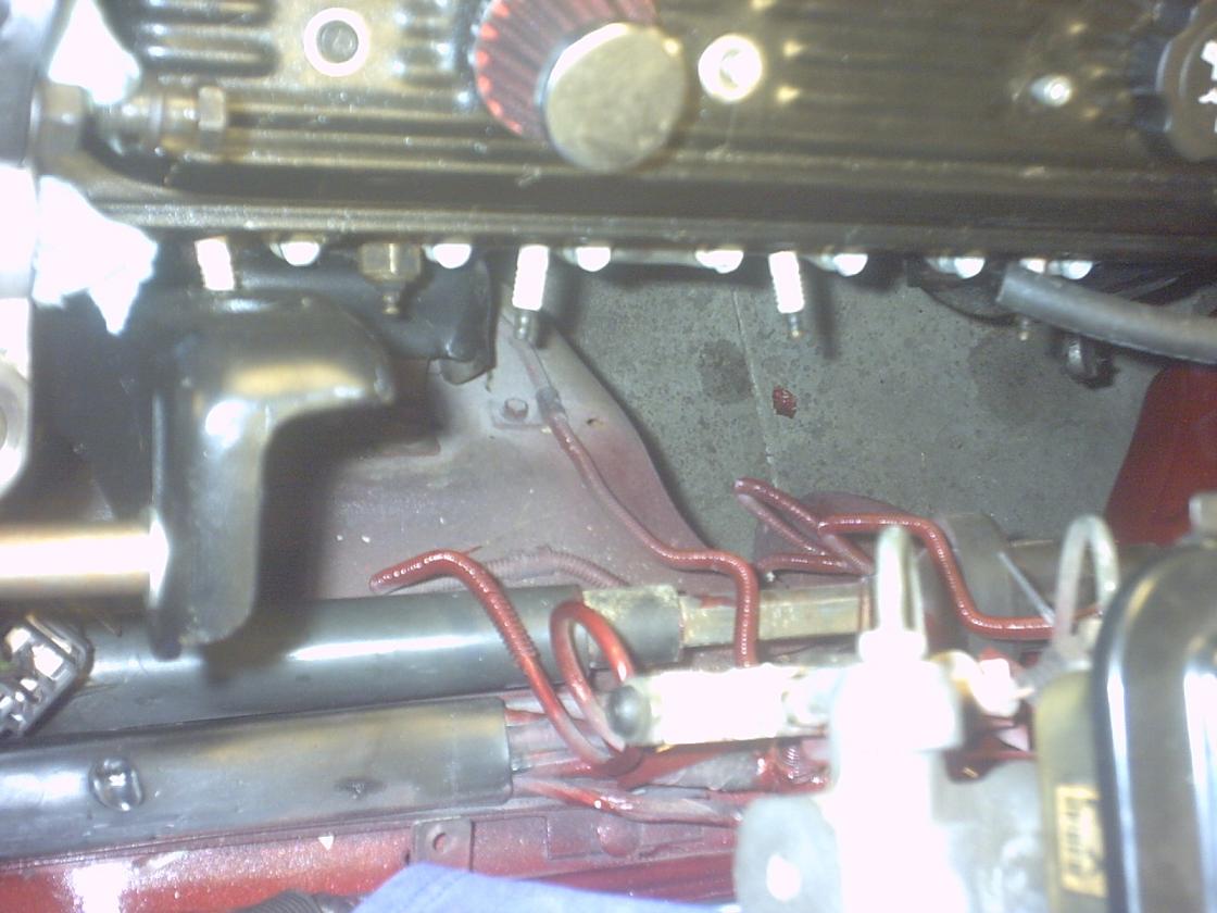

Check out this pic...I hear you, but don't see it happening. Please convince me otherwise!

I know this doesn't help, but...
A friend and I ran SLP 1 3/4" headers about 10 years ago but I don't remember the problems you are having... I do remember having the engine in the air, and then letting it down slow as we slipped them in the holes, then bolted them up when the engine was sitting on the mounts...
I'd follow sofa's advice...

Here's a picture of my LT1 with the Hedman shorties (think they're the same part number you posted)
In the car that had the V6
When i put the motor in the GTA, I had to bend the one brake line away from the header and it clears with the steering column in the original spot. Don't have a problem at all with the headers heating up the brake line. If I get a chance tomorrow, I'll snap a picture of my driverside closeup to give a better view.

Thank you...how many inches do those headers come out off the head?

ive got the SLP shorties. They fit, though they are tight. If you remove the motor mount through bolt on that side and jack up the engine as far as you can without breaking the dizzy cap, sometimes removing the valve cover helps, depends on how it sits on the head, you can wiggle them in. i ended up with the tube hitting my steering shaft, so i had to unbolt it under the dash and push persuade it over a tad to get clearance.

I moved the steering column over a 1/4" and bent several of the hard brake linds out of the way. They wiggled right in with about 3/8" clearance to steering shaft.
