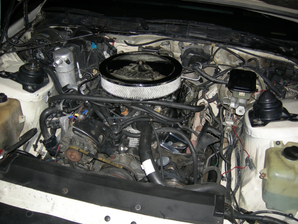

Hey all I have seen the sites showing where to look for casting numbers and the like on engines but I cannot seem to locate the one on the back of this one. I would like to find out what is in this car for sure.
I was able to locate one number below the head on the passenger side that reads: M09219VP but so far that number has gotten me nowhere. The engine is supposedly a crate 350 but I have nothing to verify that other then the previous owners claims.
The car this is in is a '84 Z28 H.O. I suppose there is a possibility it is the original engine.

I'd look at the M09219VP again. Although it may be a code for a crate engine, 9VP is not a production code. If the letters are clear and defined, then it's not a production engine.
The casting number is at the back left top of the engine. You have to look down between the firewall and the head to see it. A casting number can tell you if it's a 4" bore block or not for an easy check to see if it's a 305 or a 350 but the casting number can't tell you much more since the same castings were used over many years and in many models.

The number is pretty clear although the 0 could be an O I guess. It seems to have one of the short water pumps on it and hardware. I could not see well enough behind it even with a mirror to get any meaningful numbers off the back I will try again later today

That's a standard long water pump.
Can't tell from that photo whether it's a 262, 265, 283, 302, 305, 307, 327, 350, or 400.
Odds are it's a 305. It looks like a stock 305 with AC and dual snorkel removed, and chrome valve covers and open element air cleaner.

Because the alternator bracket is attached to the water pump, it will be a late model long water pump not a short one.
The 0 will be a 0 and not an O. I guess I should have looked up the full number.
M = GM of Mexico. It's not original and I doubt it's a performance crate engine but more likely a Targetmaster engine. (standard factory replacement engine with good but not performance castings)
0921 = Sept 21
9VP = Whatever the replacement engine code is. I don't have a listing.
The engine is definitely not original. Get a casting number to see if it's a 350 or a 305. There may be a casting on the side of the block. If the block is new enough, there will be a 5.0L or 5.7L cast into the side.
If you pull a valve cover, you will see Hecho en México cast into the head.
0921 = Sept 21

Hey thanks for the help tracking this thing down you guys I am really happy I found this site and there seems to be so many fans of these cars still.
I finally was able to find the casting number.. It is as you all suspected a Target Master 350 according to MorTec. No date info though.
10066036...350...........2 or 4...Target Master/Goodwrench crate motor, 2-piece rear
seal, "Hecho en Mexico"
I found this info on another site I have no idea how accurate it is. Maybe you guys can tell me.
