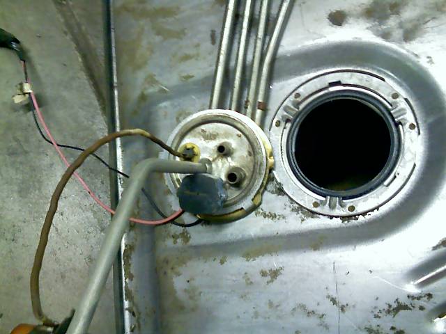

2. Where can I find a fuel sending unit for this motor that is compatible with the stock tank because the old sending unit is junk?????????????????

2. You can get a replacement unit from Autozone, Advanced auto as well, but since you're going to go carb......
3. You need to get a sender for a carb car so it doesn't have to pull through the pump, to be honest....going with the 255lph and the FPR, you would be better off, the 255's are very reliable (as long as you get a Walbro brand) I have one in my Mustang (6 years), one in my GTA with the LT1 (3 years) and when I have to replace it, I'll have one in my '98 T/A LS1 car.

I've seen new fuel tanks at the chain parts stores, but not new pick-ups. Your best bet would be to convert it from in-tank pump to mechanical-style pick-up. There's a sticky in the top section of the Carburetor forum about that.

I have found a new sending unit for about 150 bucks. I know which lines coming out of the sending unit are what. The only sending unit I could find is for a FI Camaro. It has four lines. Supply, Return, Breather, and EGR Valve something or other. Would I be able to just cut the EGR part off close to the top of the sending unit and just solder it shut because I won't need it? I figure it would have a cleaner look to it. Let me know what you think.

Not EGR, EVAP.
The stock carb pick-up has 4 lines on it, the same 4.
