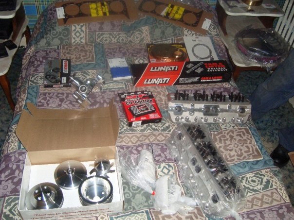

Hello everyone,
I am pretty new to the site, I signed up couple months ago when I first bought my camaro. Its been a project for a couple of months now and I am nearing the end. I wanted to get your guys opinion on what I should expect when I put it on the dyno, and what I would get at the track. I swapped the stock 305 for a 350.
Here are the main components.
350 block
10.63 compression w/ forged internals
225 cc patriot Heads
750cfm holley carb
486 lift voodoo cam
posi rear w/ 4.11 gears
wieand team g intake
1.6 ratio roller rockers
3inch hooker headers
msd distributor and cdi box
here are some of the pictures, I haven't taken any new pictures in the last month
Attached Thumbnails 86 Camaro build-1.jpg   86 Camaro build-2.jpg   86 Camaro build-3.jpg

Have more details on the cam?
Those are mighty big heads. Off the top of my head I'd say your cam is about a tenth of an inch short on lift and commensurate duration to take advantage of them. I think your dyno sheet will show you short of torque in the low range without being able to make up for it on the top end. Surely would have more power than a stock 305, but smaller heads or more cam would be a better match.
Old Jul 28, 2009 | 09:49 AM
vinny_86camaro's Avatar
Joined: Apr 2009
Posts: 6
Re: 86 Camaro build
Yea those cams are really small for now, this is going to be me and my dads car and he doesnt really know how to drive stick, I figured that ill just put a small cam in there until he gets good at it and then later on ill throw a .525 lift cam or somewherea round there.
